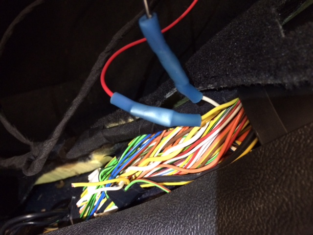

I also used the blue CA230 connection method in the front foot well to interface to rear door speakers and front door bass speakers to the new amp in the boot. I chose this method as it is easy to get to the speaker wiring which in my RHD car is next to the bonnet/hood release lever. The CA230 connection is easily accessible once the glovebox is removed from the car. I fitted my car with a Jaguar/Alpine premium audio amp, 4 Jaguar/Alpine premium audio tweeters in the doors, 4 JBL woofers in the doors and a Jaguar/Alpine sub in the boot. I could of used Jaguar/Alpine woofers in the doors too but I wanted to make the job slightly harder(!). I also added an ACM to my car in the boot (not in the factory position near the head unit) and a rear view camera while I performed the audio upgrade.

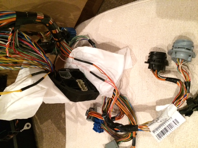

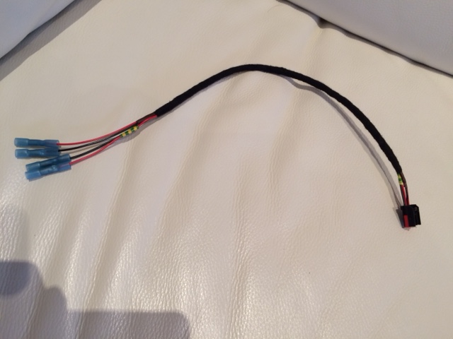

I made several looms up to connect premium audio to my car. I wanted to spend the minimum time installing premium audio in the vehicle to make the installation as “plug and play” as possible, hence the multitude of looms! I fitted the door speakers and replaced the rear door handles to take tweeters on my driveway, which took about a day of my time. I also added Silent Coat to the doors while I had the cards off and put some Waxoil in for good measure. I prefer holding a soldering iron to a hammer so after I built the looms I searched for a company who would assist me in disassembling the interior of the car to install the looms & associated equipment. After a couple of false starts I discovered DF Communications in Aberdeen, UK. I met with one of their engineers who was extremely helpful and was happy to assist with the install. I booked the car in at the DF workshop for a full day for the main loom, sub and amp install. This work took about 6 hours to complete. I would highly recommend DF for any car electronics installation work. DF were the only people I found who would take on this project. I have no connection with DF, apart from being a happy customer. DF have a website at www.dfcommunications.com and their phone number is 01224 588844.
I created a document which ended up being 30 pages long with the upgrade details to capture everything. This document is too big to upload and much of the information it contains it also available elsewhere. I’ll upload points that may be of use to others from my document though. Excuse my wiring diagram, I didn’t have access to a drawing program when I produced this masterpiece.
Audio Amp Speaker Loom
This loom connects the Jaguar/Alpine amp mounted in the boot of the car to the CA230 connector in the front foot well, to the front door tweeters and to the sub in the boot. The loom uses a 18-way Multilock to connect to the amp, a TE Connectivity 4 way to connect to the sub and a male/female pair of blue JST Automotive PB2 16 ways to connect to CA230 in the car. The standard audio system supplies 1 speaker pair to each front door, that is split to feed the front door tweeter and woofer. The premium audio system has an output from the Alpine amp directly to feed the front door woofers and front door tweeters. The standard system has a woofer in each rear door and the premium system has a woofer and a tweeter in each rear door. Both standard and premium systems feed the rear door speakers from a single pair via CA230.
Looking at the Jaguar wiring diagrams I could see that the front door tweeter and front door woofer are wired independently through the door to the passenger area of the car and connect together at CAS15 & CAS16 and CAS17 & CAS18 on the standard system. I wasn't the first person to notice this! To stop having to pull cables through the doors I wanted to tie in to the existing harness on the passenger side of the harness. With this in mind I bought a scrap interior loom for an X type so I could see where CAS 15-18 were. As can be seen in the photos CAS 15-18 are very close to the CA230 connector. The 4 front door tweeter wires along with the D2B wakeup signal on the amp power loom are the only wires I had to cut on the car to install the system. The left side door wires were cut near the fuse box under the dashboard, which is awkward to get at. I found this task very easy though as DF completed this bit! The right side door wires were cut near CA230 after the sill cover trim had been removed (next to the front passenger seat) and is easily accessible. This saved having to pull a wire to the right hand front door. Bear in mind the standard and premium tweeters have a capacitor installed on one leg, so if you are buzzing signals out with a DVM you might see some resistance changes as the cap charges. The pictures I’ve attached were taken before I used loom tape.
Audio Amp Power Loom
The audio amp power loom uses a 12-way Multilock connector to interface to the amp. Two earths, two 12v permanent feeds and a D2B wakeup signal are required on the connector. Two power feed pairs are required as the amp can pull 30amps and each Multilock connector pin is rated at 15amps. I used the rear mounted accessory socket CA146 in the boot, which is rated at 30amps, to provide power. The OEM amp install on an X type uses unswitched power for the amp and so I did the same. Acc switched power is also available from the same rear mounted connector if a C2S48039 relay is installed behind the glove box in position R2. D2B wakeup is available from the D2B connected devices in the boot, I pulled mine from the DVD nav system by splicing the orange wire.
Front Door Looms
I used Jaguar/Alpine premium audio tweeters for all four doors in my car, meaning the front door tweeter connections required no changes behind the door cards. I used JBL speakers for the woofers in all of the doors so I made up some small looms with 2 way Multilock connectors to interface to the existing door loom and crimp terminals to connect to the new woofers. The Jaguar door wiring could be cut here instead of making a loom but I wanted plug and play, hence I used this solution.
Rear Door Looms
My car only had woofers in the rear doors and I needed to replace the woofer and add a tweeter to each door. The tweeters mount in new interior door handle surrounds that I sourced from the front doors of a scrap car and fitted to my rear doors. I used a large drill bit to trim the plastic away from the original cards to remove the handles. The loom for the rear door comprises of 2 way Multilock connectors to interface to the existing door loom, crimp terminals to connect to the new woofers and Multilock FH 2 way connectors to plug in the new door tweeters.
D2B Optical Loom

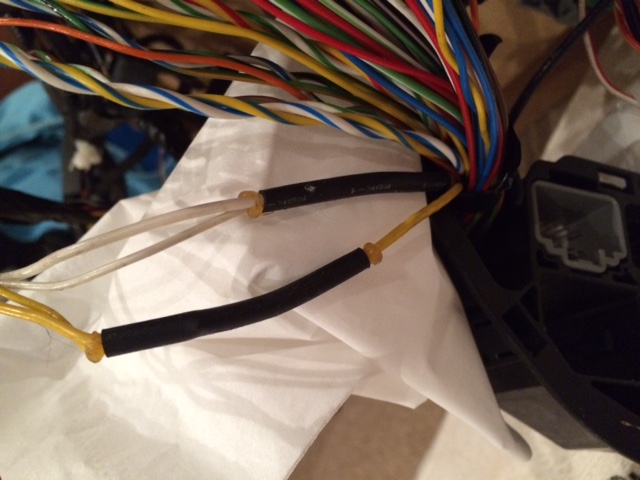

I originally intended to add an additional connector to the D2B network for the amp. Due to space constraints in my estate and the fact I never use the 6 CD changer as I have an ACM I chose to remove the 6CD changer and use it’s D2B connector. If I had decided to keep the changer I would of added another D2B connection point via a scrap D2B harness I have and robbing it for bits. Alternatively I could of used another ACM harness, PN C2C38901, which would provide an additional D2B connection point for a plug and play install.

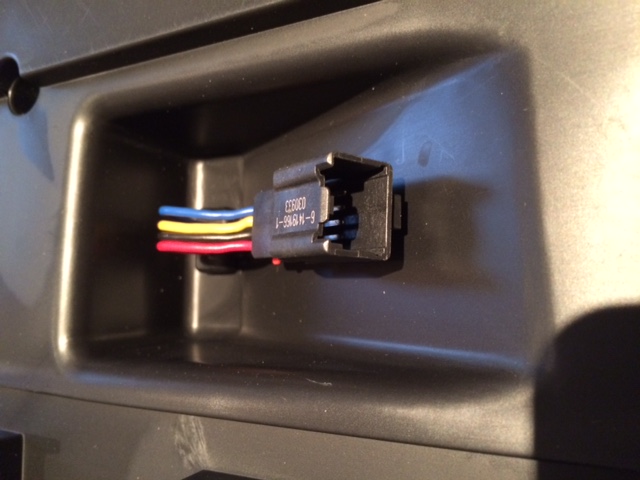

To add tweeters to the rear door handles I bought front door handles from a scrap car. I then removed the rear door handles from my car and fitted front door handles. Removing the rear door handles was easy, I just used a large drill bit to carefully trim the plastic away from the circular handle mounts. I wanted to leave as much of the circular mounts in place as possible as and I intended to use self tappers in these holes to locate the door handle while the glue cooled. I used a Stanley knife to remove the other straight sections of plastic that were used to hold the handles to the doors. Again I only removed the minimum necessary as I wanted to use the straight sections of plastic to locate the new handles while the glue cooled. After I had screwed the new handles to the door cards I used plenty of hot glue to hold them in place. I also applied some hot glue to the tweeter mounts in all 4 doors as there was a small amount of movement in them.

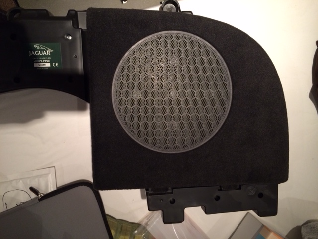

The sub woofer mounts via m6 bolts to the car. The bolt holes were present on my vehicle but the holes were not tapped. I used an m6/1mm tap for this. The sub woofer cover trim mounts to the existing car trim and the sub, no additional hardware is required. The polystyrene boot tidy under the boot floor that sits under the offside cubby hole needs cutting to allow the sub to fit.

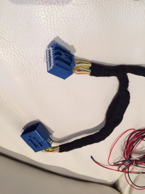

Rear Door Looms

Thanks to X-Dave and Cambo I have comipleted successfuly my project of premium sound upgrage, but thetre is one small issue I have no clue how to sort out.
I have CD changer and AMP in the trunk and original fiber optic loom phone-amp.
Have checked it with the light if any of fiber optic link is not broken and all looks good.
The issue is that using simple cdc fiber optic I can use CDC if I disconnect from CDC and plug it to AMP Premium Sound kicks in. Seperately both CDC and AMP wors fine.
When I want to use them both using loom Phone-AMP CDD and AMP both do not work, tried all options and from the connection diagram all looks good but do not work.
here is loom connection scheme:
BOOT 1 to CDC 2 CDC 1 to AMP 2 AMP1 to BOOT 2
"wake up" orange cable loomed from CDC to AMP
as I mentioned CDC and AMP used on CDC cable BOOT1 to CDC2 CDC1 to BOOT2 works fine
HELP! what needs to be done? is there any chance that I have to program system to use AMP and CDC at the same time using mongoose?
just checked again and now CDC is working but AMP is dead. It was working on CDC loom few hours ago. Could I broke it by switching fiberoptic order while troubleshooting loom or is it possible that my system cancelled it and left only CDC. My radi is not touch screen it is standard CD player and climatronic Unit.
I am depressed 2 full days of wiring soldering and hard work in interior was happy to hear my sound for few minutes and now stuck with AMP not working and no sound at all.

After few hours of digging it appeared that amp orange cable had cold connection to orange cable “fiber optic wake up” and when soldering again everything came back to life and my loom CDC APM made from phone amp loom works just perfect. successfuly also upgraded my CD dash player with line out that connected to my parrot mki9000 plays music via cd line over Bluetooth and hands free works well just have to remember when listening to the radio to switch into CD to answer or make calls hand free!!! How to upgrade CD line out thanks to JagDroid See link below https://sites.google.com/willcoxonli.../jaguar/part-4
mission completed
