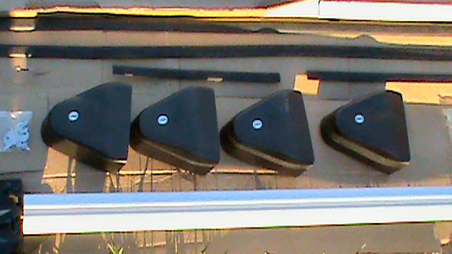

Two bars
Parts bag to include 1 Allen key, 4 thread cleaning bolts, 4 retaining assemblies, 4 spacers
End caps, keys, and rubber inserts.

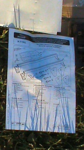

Fitting Instructions

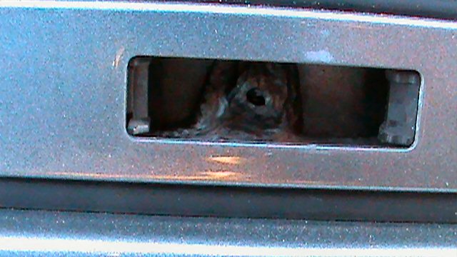

Punch out the holes in the roof.
Mounting threads down inside the holes.
Cleaning out the threads I used one of the four thread cleaning bolts on all four holes. It just mushes the goo out of the way. Screw it in, take it back out, clean threads.

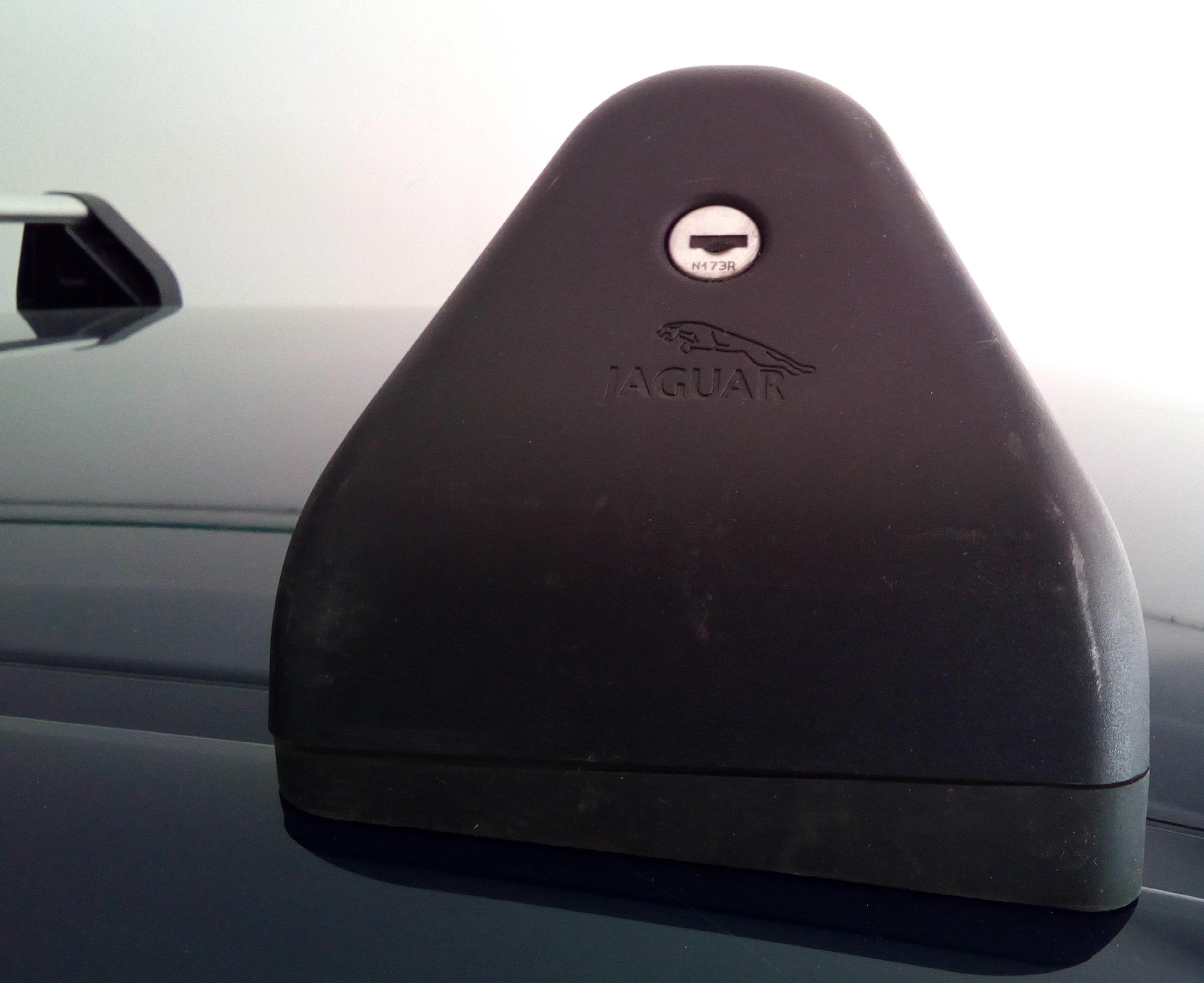

They are made by Thule so you can easily get spare keys ( in the UK ) by Noting / quoting the number on the lock.

the "new" roof rack for my x type (buyed on second hand here in Italy)
