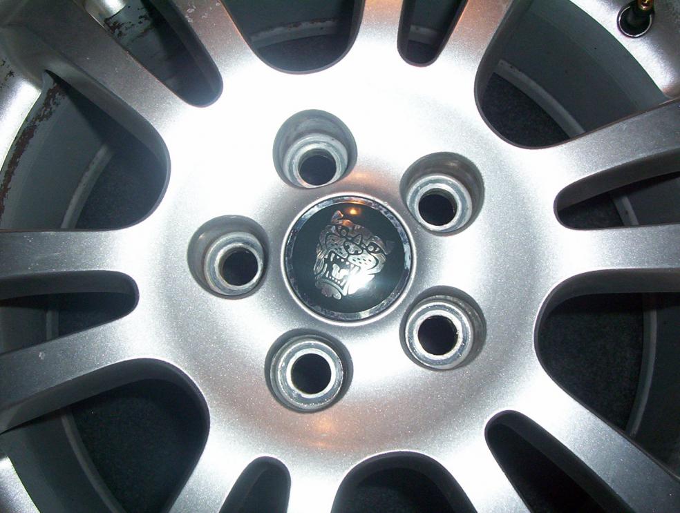

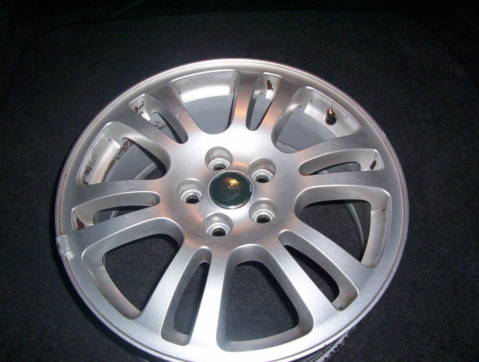

I came across a great deal on 17 inch OEM Jaguar wheels. The wheels are 17 inch and they look like they are off a S-Type.
17x71/2
1) They seem like they will fit.. Will they?
2) Anyone else running S-Type wheels on their cars? Post some pics..
Give me some input. And here are the pics of the wheels.
Attached Thumbnails S-Type wheels fit on X-Type?-100_0492.jpg   S-Type wheels fit on X-Type?-100_0493.jpg   S-Type wheels fit on X-Type?-100_0494.jpg

Pete, the wheels should be interchangeable. So, if you can get them. go for it. They have the same backspacing and bolt pattern. So, you should be good.

That is what I was looking to hear.. I will pick up some new tires and they should look good on my X-Type..
