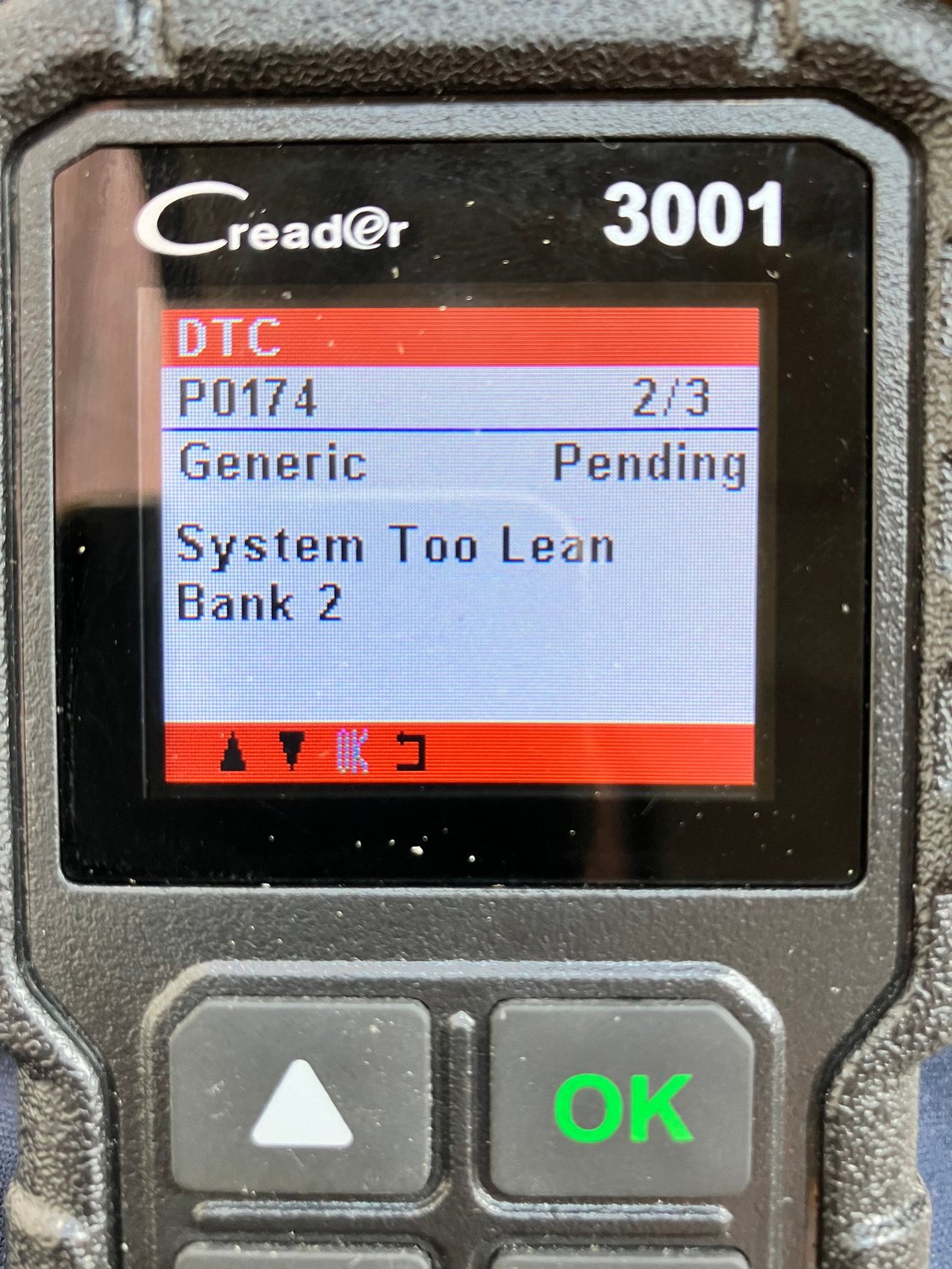

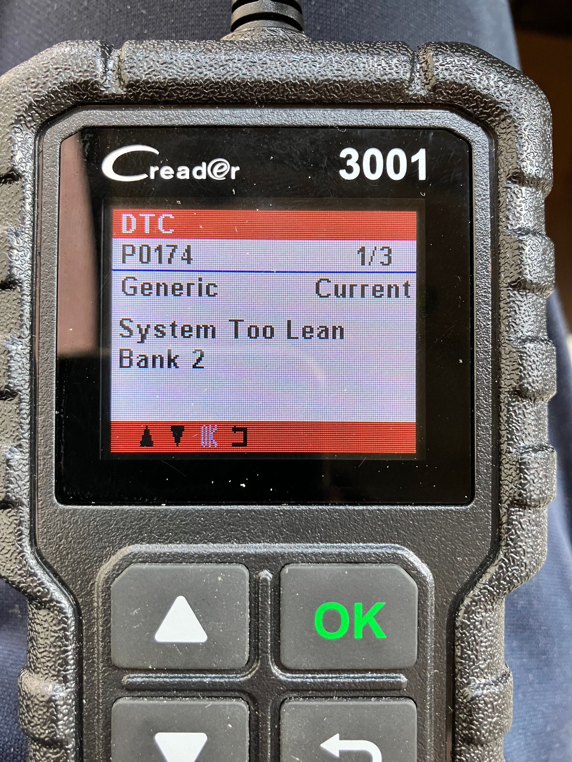

Hello guys. Had a P0174 bank 2 too lean code a week or so ago. Mechanic said he changed out all 3 coils in the rear cylinder banks. Just picked up the car. Next day. Same code again !! He’s a competent mechanic. Just askin u guys before I bring my car back to him. Thx in advance

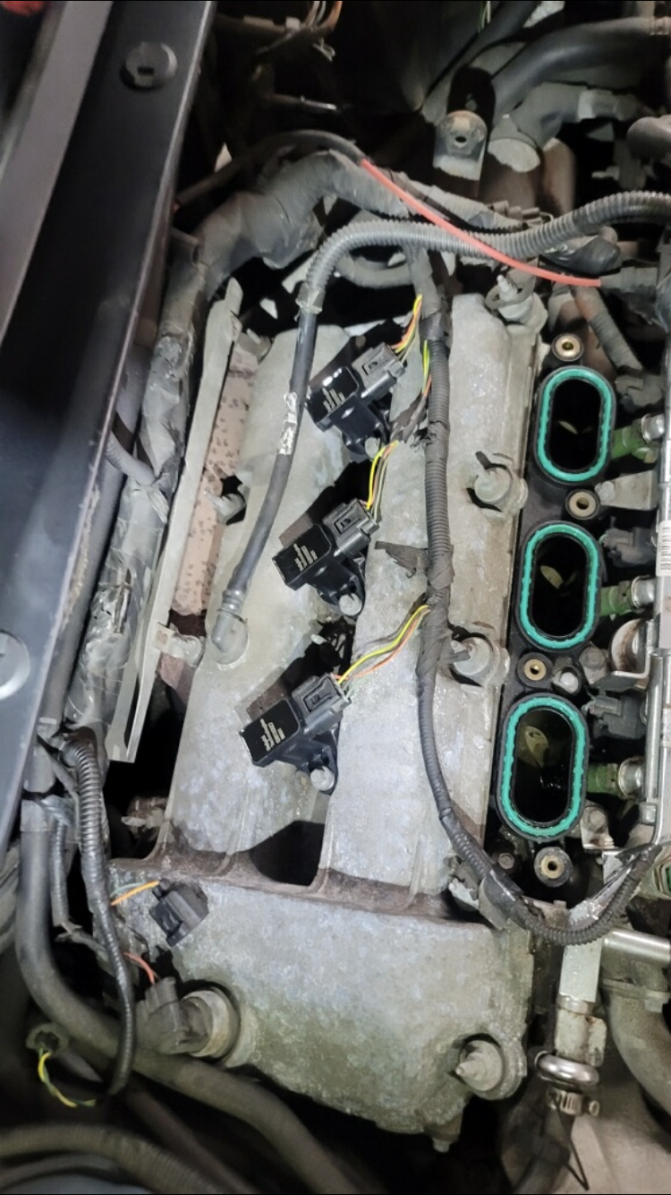

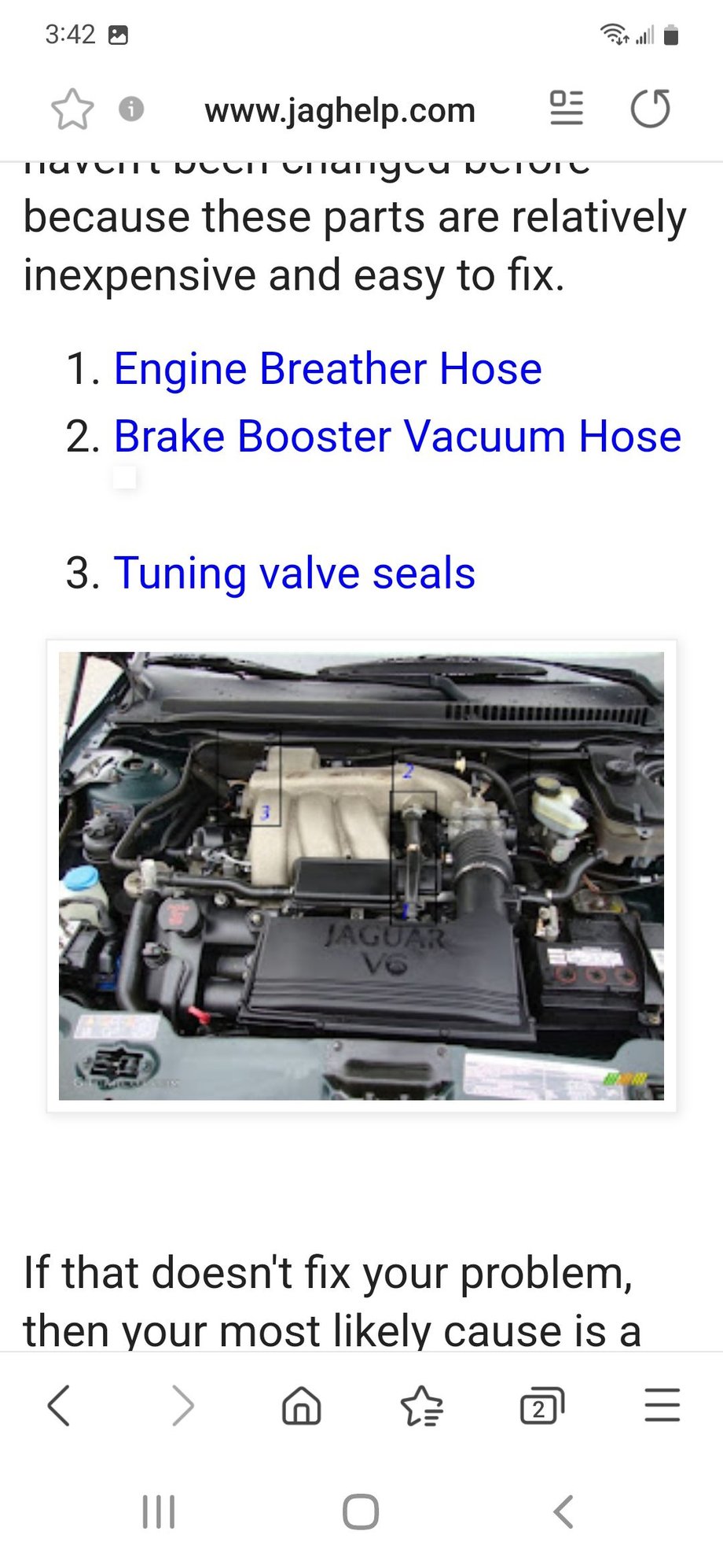

NYCJag, whenever you see P0171 or P0174, you should always verify that the big 3 are good (ie, PCV hose, brake booster line, and the IMT valve o-rings). In your case, I would venture that our IMT valve o-ring is your source of vacuum leak. If those are all good, it would appear that your mechanic put a new set of upper o-rings in, but did he do the lowers? That would be my next suspicion.

If it's not one of the "big 3" vacuum leaks, this is the next culprit. Curious he changed coils etc. For a p0174 code which MOST times is a vacuum leak.

Wouldn't those normally throw both codes (P0174 and P0171?) or do they sometimes just throw one of them? In any case I had both codes again last week after chasing them down a few months ago, the very first thing I checked was to pull the fuel purge line from the intake (just like the brake booster line in how it connects to the intake manifold) and saw that the tiny O-ring inside was broken whereas it was fine the last time around. Replaced that O-ring and sure enough that solved it, the check engine light turned itself off after five drive cycles. Those rings get brittle from the heat.
And per Thermo's second suggestion, last time I had those codes, it was in fact the lower gaskets. They aren't very difficult to get to if you're already at the rear coils, maybe another 10-15 minutes working slowly but it seems nobody seems to replace them until forced to.

Check the "big 3"
