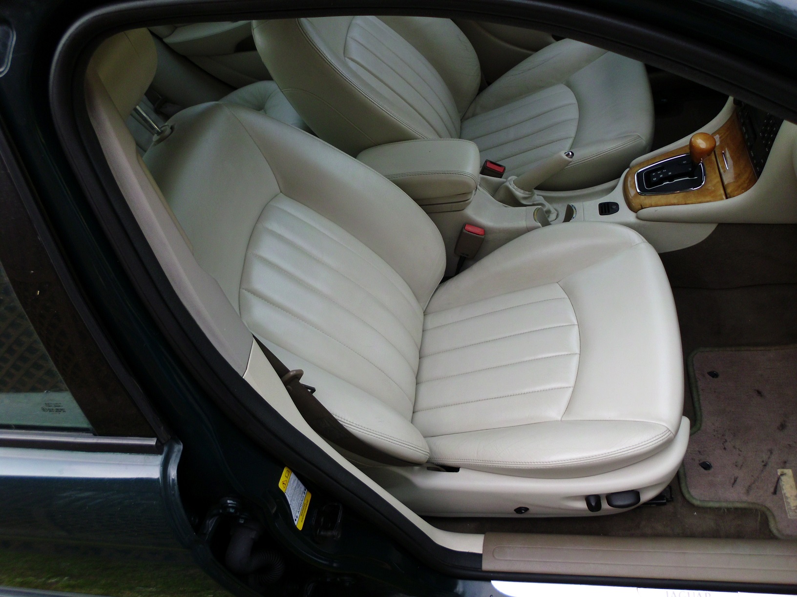

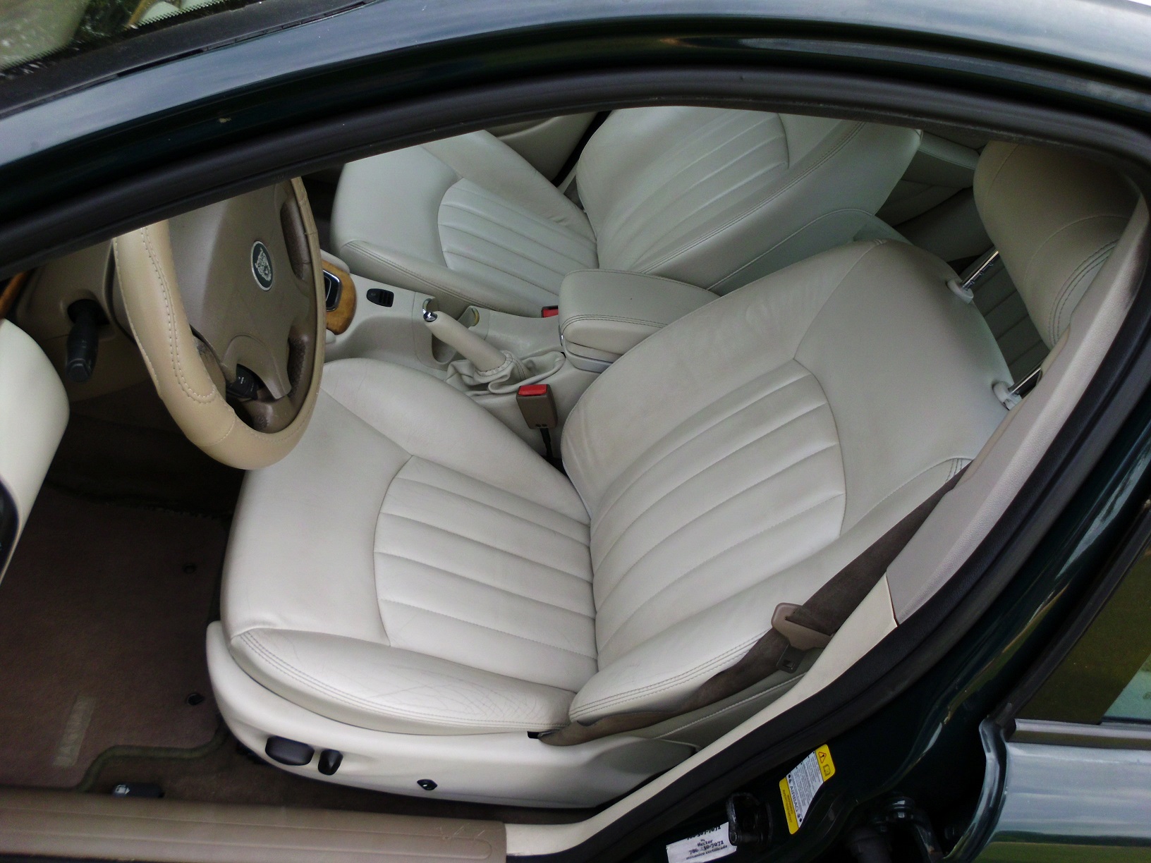

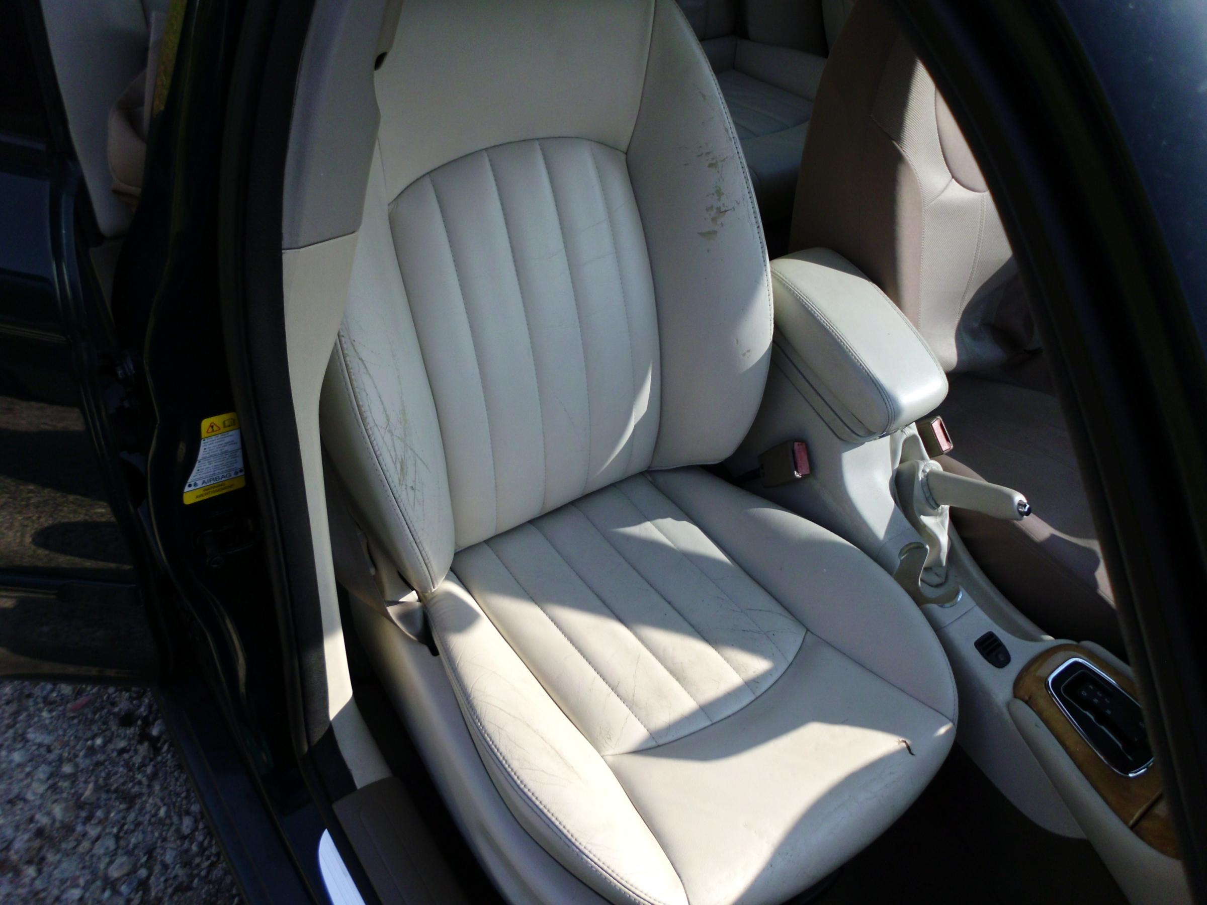

-Old Passenger Seat-
Seat Upgrade - Looking For Confirmation of What I think I Already Know...-old_pass_03.jpg
-Newer Passenger Seat-
Seat Upgrade - Looking For Confirmation of What I think I Already Know...-new_pass01.jpg
-Old Driver Seat-
Seat Upgrade - Looking For Confirmation of What I think I Already Know...-old_drv_01.jpg
-Newer Driver Seat-
Seat Upgrade - Looking For Confirmation of What I think I Already Know...-new_drv_01.jpg
*** UPDATE - Seats In ***
Well it took about 1 hr to get the old passenger seat out and the new (to me) seat in. When I started the car, the passenger airbag light on the dash lit and then went off as normal. Still gotta pull codes and gonna get the calibration/programming checked to ensure restraint system is 100%.
The old driver seat had a bad motor on the seat height adjustment and the seat support bar blocked access to the seat belt anchor screw. So I had to completely remove the old driver seat from the car with the seat belt still attached (should have taken a pic of that ), uncouple the height adjust motor arm and manually lifted the seat support enough to get to the screw. Got that off and reinstalled the newer driver seat. Everything works great.
Cleaned and conditioned both seats and are much happier with newer seats than old. Ordered hazard/seat warmer dash switch and should be installing next weekend.
The seats only cost me $100/ea and the driver seat has some cracking/wear. I ordered leather dye from Gliptone Leather which should minimize the crack effect - my next project.
These things are one step at a time for the po' .....
