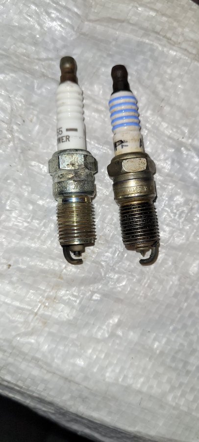

Also this is one of the spark plugs the one on the left is new one the left is the old one the guy had already changed before I bought the car

@Thermo Hey thanks for all the help u gave I figured it out it wasnt a coil or spark plug issue lmao I didnt plug in one of the pressure hoses so it was leaking and I couldnt tell because the engine was shaking yk. there still is the coolant leak I need to get a new coolant water pipe outlet with the o-ring, any places I can get it for cheap in canada,vancouver

Help, here is a list of plugs that I would tell you to look for:
Amazon.com: 6 pc DENSO Standard U-Groove Spark Plugs compatible with Jaguar X-Type 2.5L 3.0L V6 2002-2008 Ignition Wire Secondary : Automotive
Bosch Platinum Spark Plug 6747 (autozone.com)
Autolite Platinum Spark Plug AP103 (autozone.com)
Motorcraft Platinum Spark Plug SP-479-X (autozone.com)
