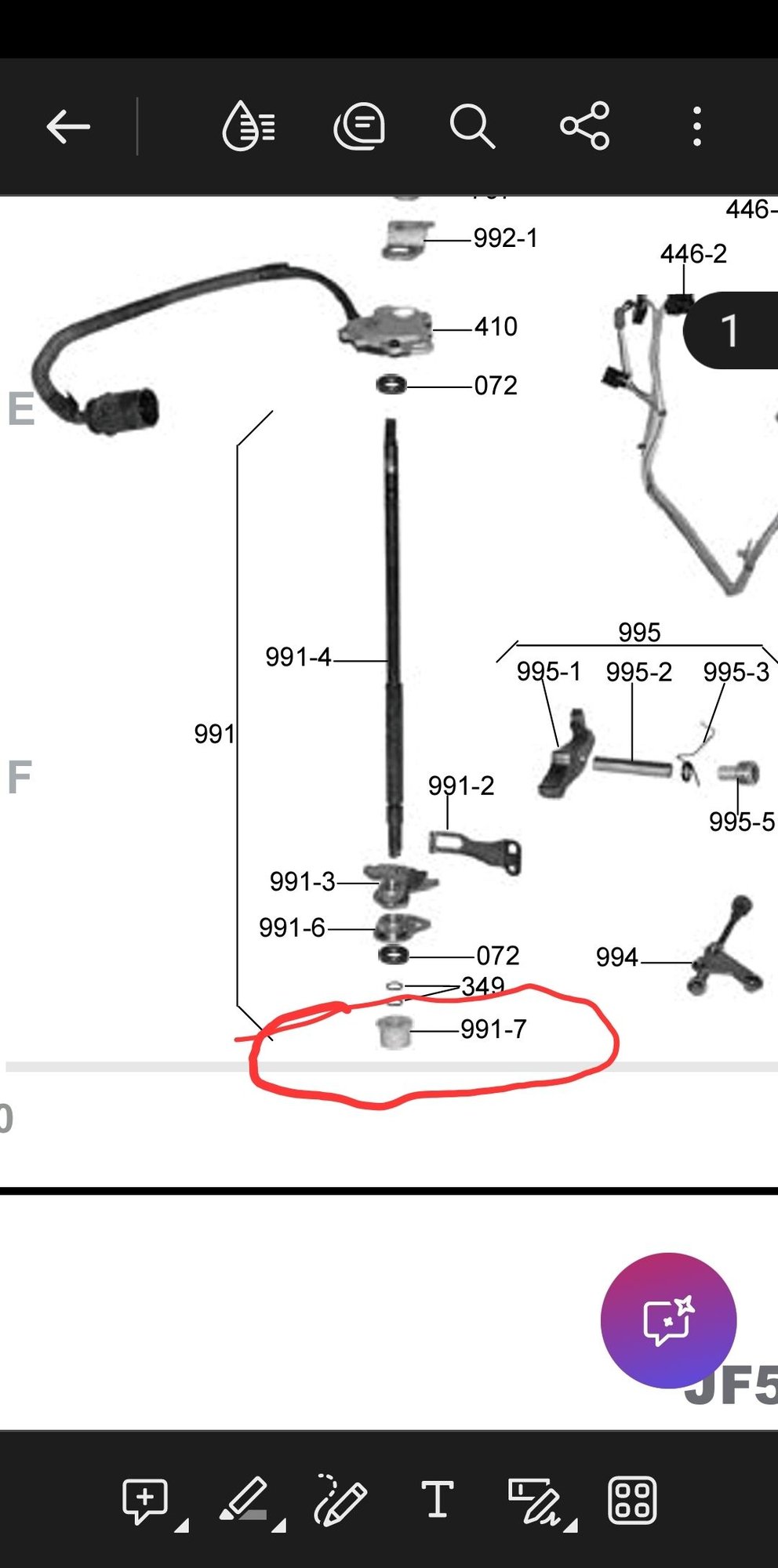

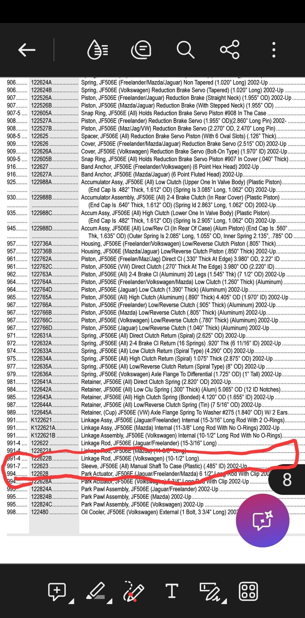

Old Mar 14, 2025 | 01:43 AM
Dell Gailey's Avatar
Joined: Mar 2017
Posts: 4,770
Likes: 795
From: Utah
Old Mar 14, 2025 | 08:51 AM
Floatcat's Avatar
Joined: Nov 2024
Posts: 21
From: Cumberland, ME USA
Excellent info; I trust that the bushing/sleeve is the same for both automatics and standard shifts?
Thank you!

The selector shaft sleeve is "obsolete" ... unavailable form any sources; Jag dealers, Jag Bits, Welsh, etc.
A used one will probably be junk and I doubt any boneyard will extricate one from any salable transmission that they may have in stock. So it looks like I will have to make the part.
I'm pretty sure mine will be toast by the time I get it out. Does anybody know where I can get the specs for this part so I can have fabricated? ...... possibly 3D printed?
