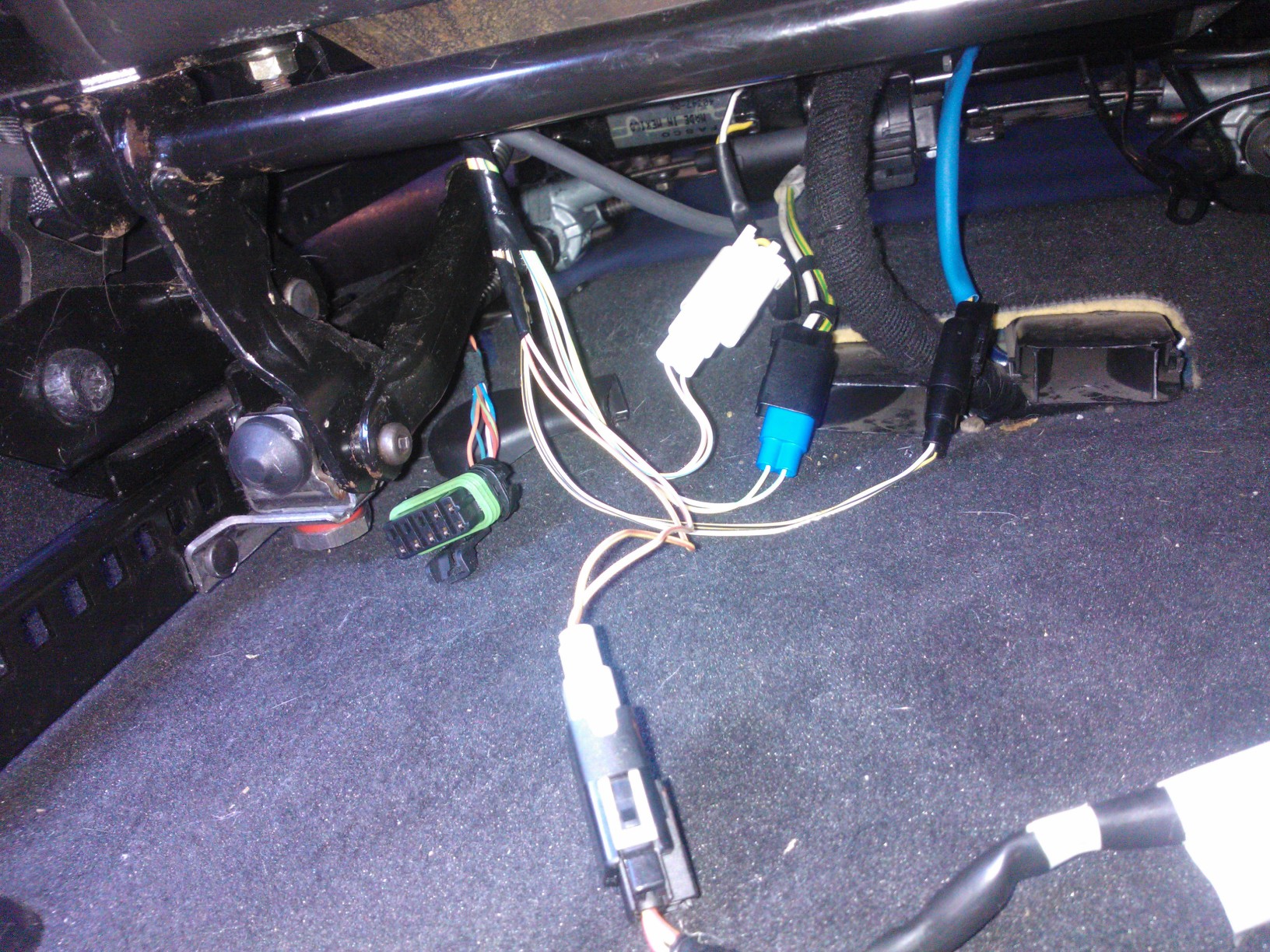

I am tried to get to the bottom of my B2290 code 16 airbag problem. I have attached a photo of the underneath my passenger seat. To me it looks like a rats nest of wires… all of the plugs seem to be connected except one? Should this be?
Thermo, which plug is attached to the pressure mat? And what do all the rest of the plugs do?
Kind regards

Cyberice, the 10 pin plug on the left is your main connector that powers the seat. The 4 2 pin plugs are what feed power to each of the motors in the seat (the up/down motor, the front/back motor, the tilt motor, etc).
I am not sure where the passenger seat pressure sensor ties in. It should be a 3 wire plug with a red wire, a white wire, and a blue wire. Odds are, this plug is going to be over near the seat belt tie down.

I believe that the 10 pin plug has never been plugged in but the seat motors work fine. I will have another look around near the seat belt tie down. For any red,white,blue wires.
Watch this space...
