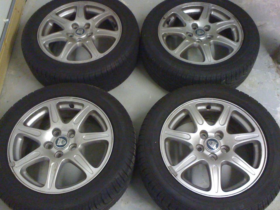

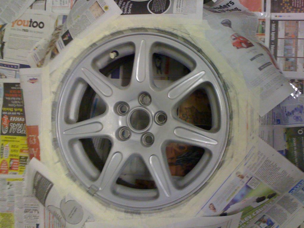

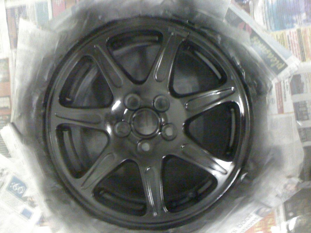

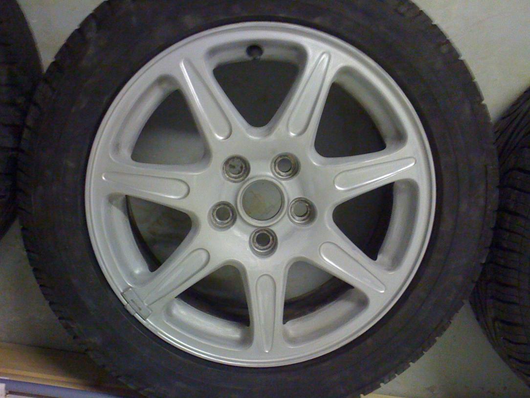

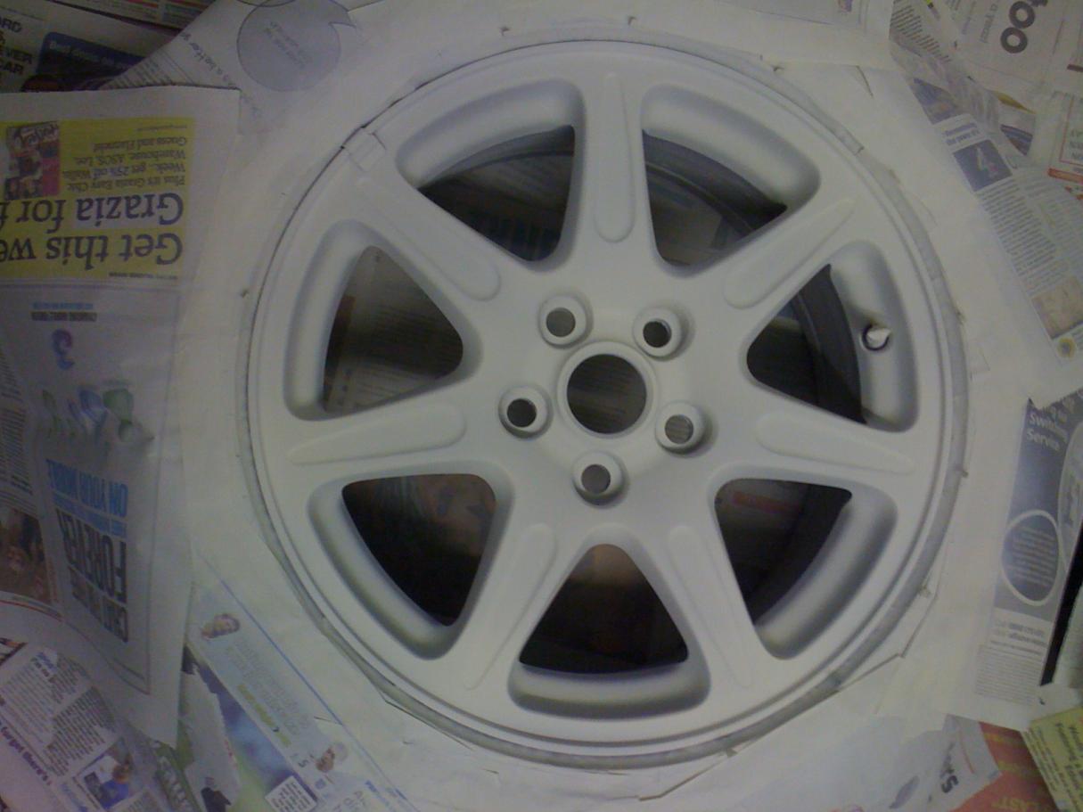

So I finally got a day off work and decided to get on with cleaning up the standard rims for xmas. Took pictures to show.
Tools:
Masking tape,
Newspaper,
Sand paper (800 grit and wet & dry),
White Simoniz primer (2 x 500ml),
Black gloss Simoniz spray paint (2 x 500ml),
Simoniz clear lacquer (2 x 500ml).
Attached Thumbnails Standard wheels DIY refurb. UPDATE!-1-standard-set.jpg   Standard wheels DIY refurb. UPDATE!-4-sanded.jpg   Standard wheels DIY refurb. UPDATE!-7-prepped.jpg   Standard wheels DIY refurb. UPDATE!-9-white-primer.jpg   Standard wheels DIY refurb. UPDATE!-12-gloss-black.jpg

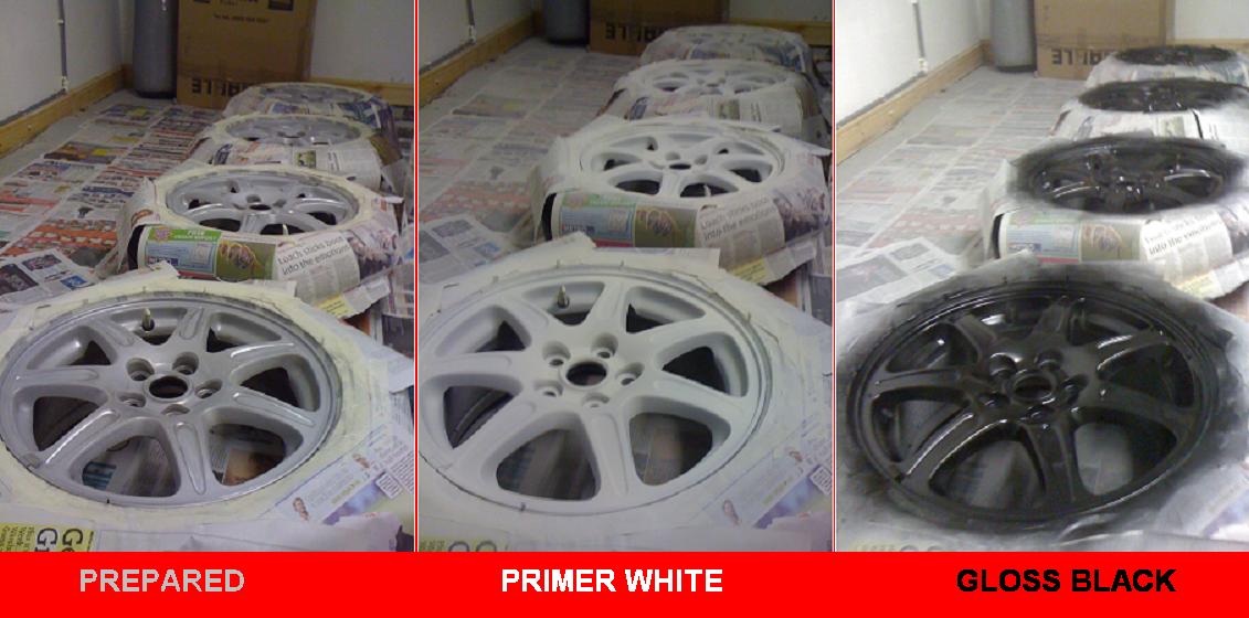

Extra picture, Three stages of prep, primer and paint.
