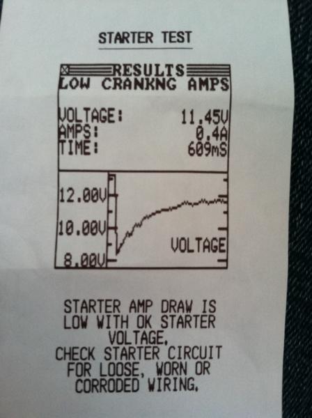

My guess would be that your solenoid is either a little bit corroded (causes very weird problems) or it's that your power wires are corroded. Either way, I would point to corrosion being the culprit, or in a very slim case it could be a problem with your battery. That's just my 2 cents though. What problem were you having with the starter?
jagman, what you see there is classic symptoms of a high resistance connection. If they connected the tester across the battery (like they normally do), then that pretty much proves that the battery terminal is on its way out and you will need to replace one (if not both) of the cables here in the very near future. The other thing that it can possibly be showing is you have a cell that is starting to go. As the current needs of starting the car grow, the bad cell causes the output voltage to drop significantly (it is essentially starting to reverse itself and become a load on the battery vice being a source of power). Because voltage dropped to 8.5 VDC, it is also very possible as each cell of the battery generates 2.1 VDC. So, mix the high current (which normally drops the voltage to around 11.0 VDC with the cell not producing 2.1 VDC, it is pretty damn close.
