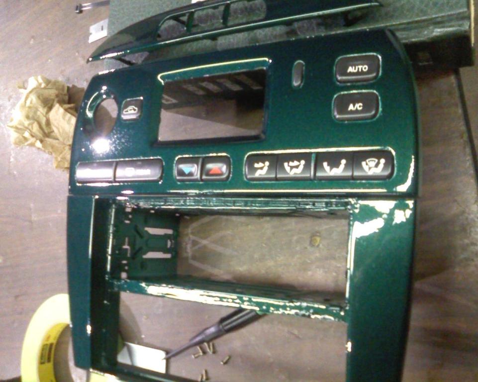

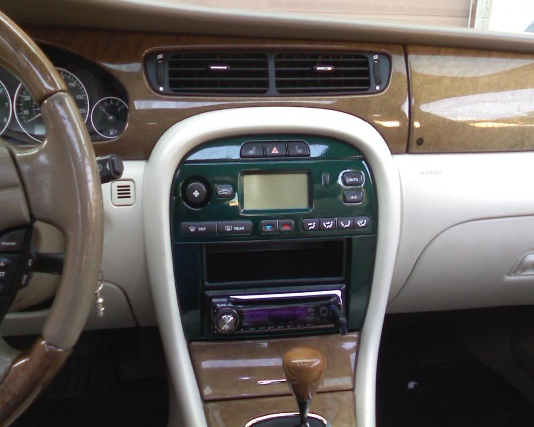

just some pics after wards. the base is g41 mitsubishi green i had left over from a car i did and nason clear coat.
shotty pics from my phone but its a deep green matallic.
