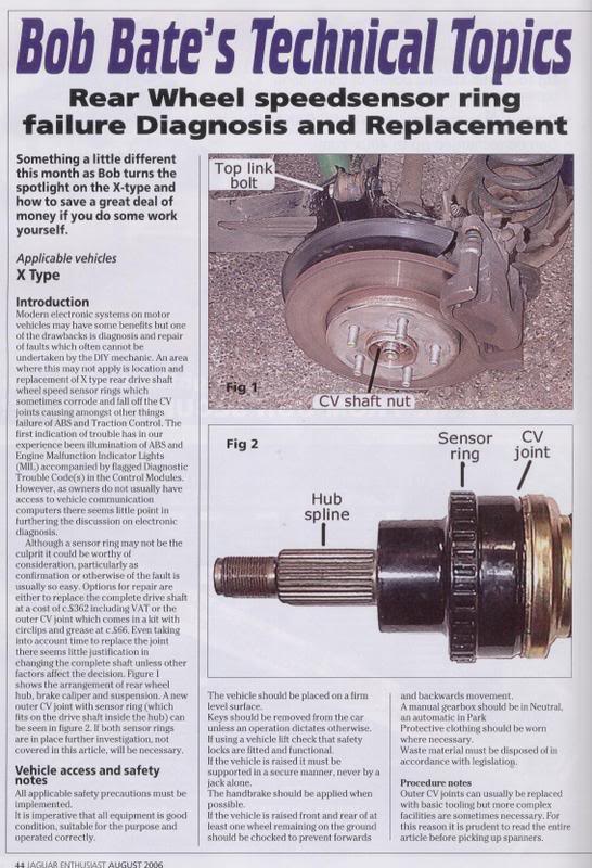

What do cvus cost on this and how hard are they to change?

Default RE: Suspension Noise when i turn
They cost around £66 and are fitted in under 2 hours like this:-

Well there ya go....don't get any better...
