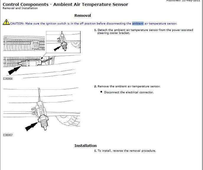

I am assuming you are pressing the external temp button. Yes it does make a difference in my XJ8 I could only get heat with the heat set to HIGH. The external temp said it was a 137 degrees outside and wanted to run the air conditioner in 30 degree weather.
Below is a view of where to find the sensor. I don't remember when I changed the one in my X-Type if I was able to reach thru the bumper or had to take the splash guard off. Thru the bumper I think.

Larry, if your temp is bouncing all over the place, yet is a fairly accurate reading (ie, not pegged high or low), then odds are your problem is the sensor itself. If you have a wiring issue, it will tend to bounce to the max indications.
