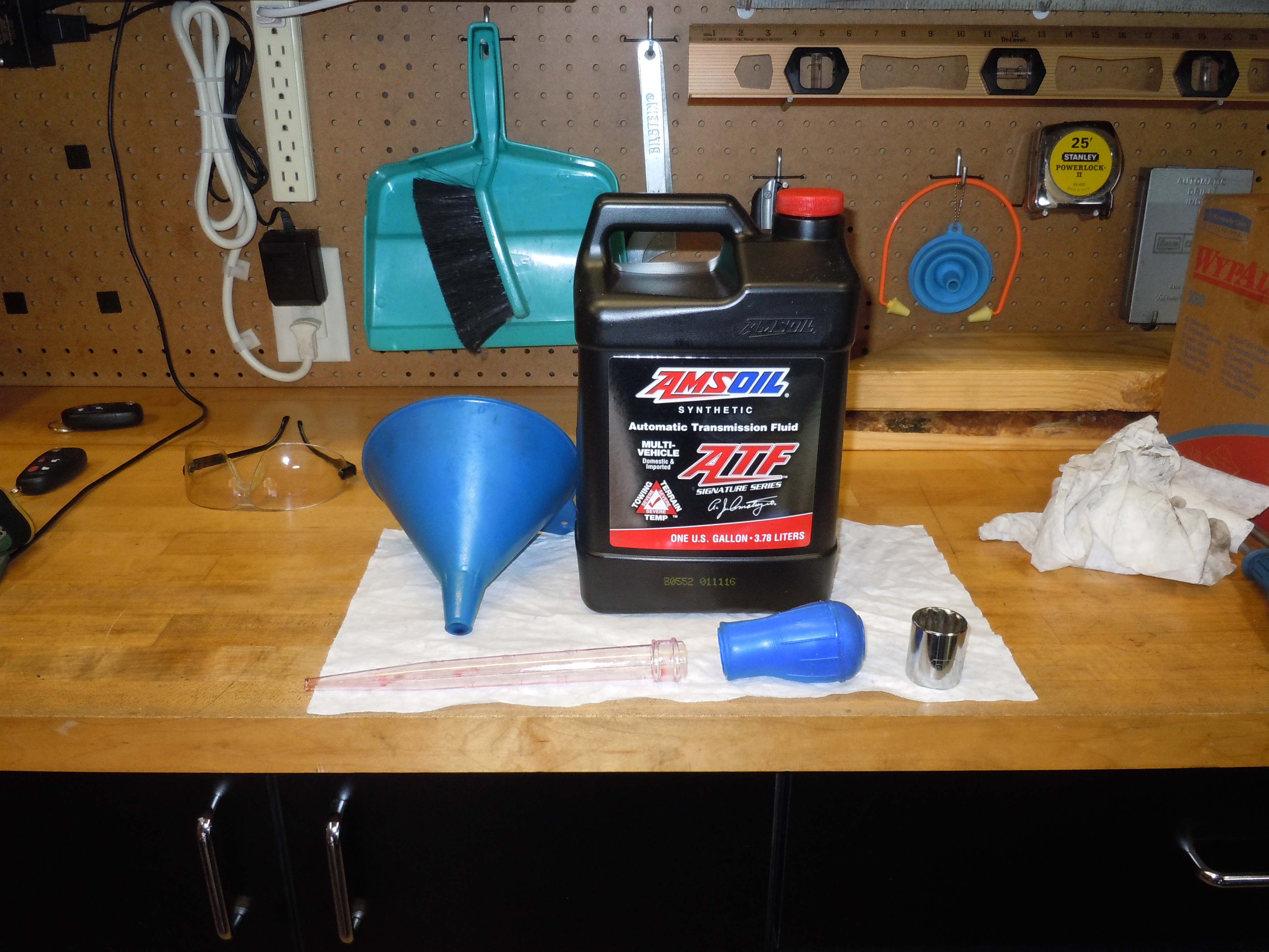

The ATF spec called for is Idemitsu K17 (Jatco 3100 PL085), so look for that when you're shopping. For the last 19 years I have used AMSOIL fluids in all my cars. I recently acquired a 2004 3.0 AWD with 105k miles, and one of the first things I did was change the ATF. I did the drain/refill three times as others have recommended, and the transmission operates much smoother. This Signature Series fluid meets the Idemitsu spec. Once you locate the drain plug underneath and fill port topside (I recommend removing the battery) it's pretty easy, especially the second and third times. It's not necessary to raise the car but you can if you want. I did not bother with Jaguar's method of checking fluid level; I simply refilled with 3.5 quarts after each drain. My write-up here: https://www.jaguarforums.com/forum/x...4/#post1468082
