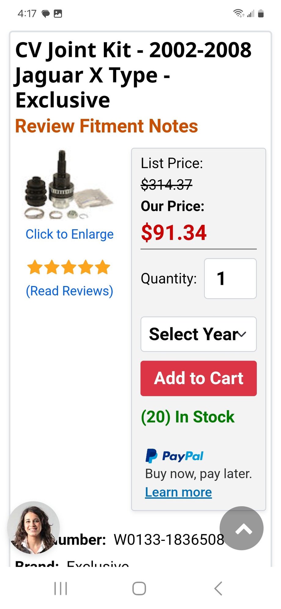

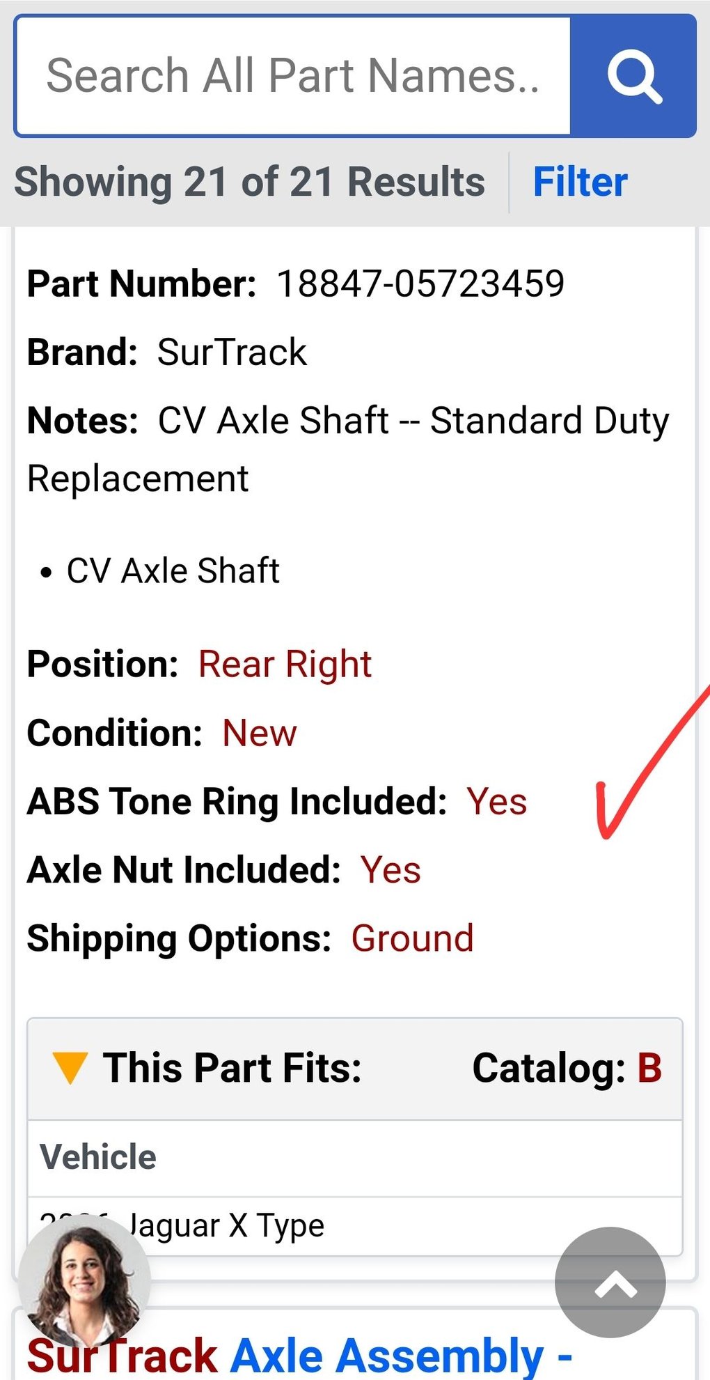

In case you decide to go the cheap route, reluctor ring at Welshnet
The rear half shaft with reluctor ring is a little cheaper at SNG Barratt, $82 currently.
