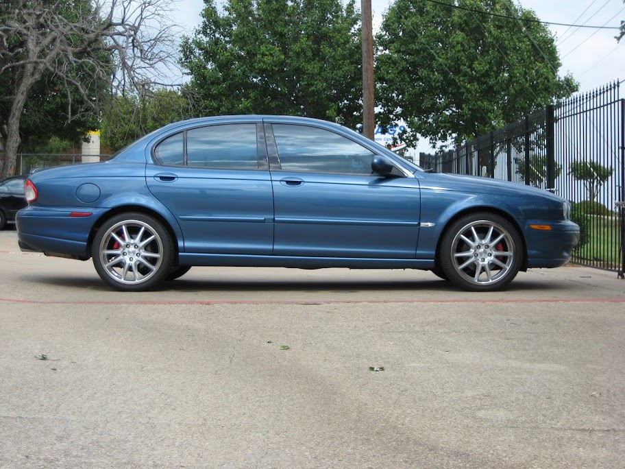

Yes you can upgrade the wheels size...for every rim size you go up the middle number of a tires dimension go down...for example 225/45/17....225/40/18...225/35/19...225/30/20 (possibly 215/30/20)
If you change the size of tire you change the overall diameter and there is no reason to have anything calibrated.
What kind of wheel are you looking for? You can get some nice wheels from tirerack.com that sometimes look very similar to rims offered on jag straight from jag.
These were my 18's

Those are some nice looking wheels on all your x-types..
