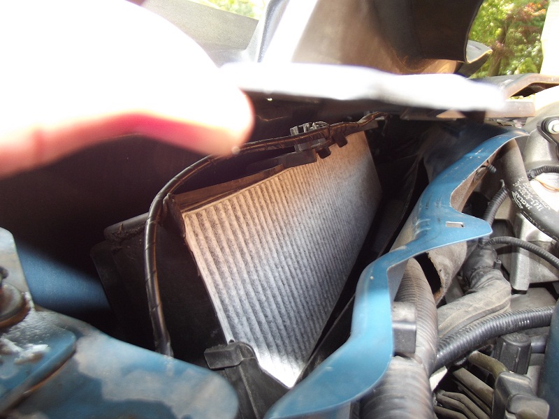

Hello. I also have the same problem. I used the search tool but did not find any info that was very helpful to me. I did pull the retainer pins so that I could take a look at the filter. I heard alot of people say that the filter is not in position right witch will cause water to leak in. After looking at the filter and seeing how dirty it was I decided to replace it with a new one.

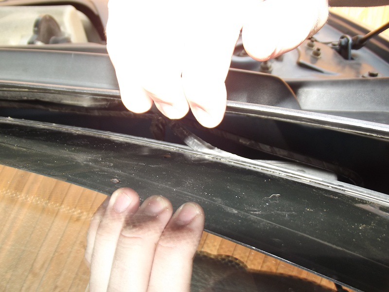

With the new filter in I an certain that the filter is installed correctly. I did notice that when I pulled the shroud up to get to the filter that the "lip"(the part the tucks into the windshelid) part the the shroud has separated from the shroud. Is that what is letting the water in? When I did my search one person said that even with that "lip" being separated it dose not have anything to do with water making its way in. To me it looks like that is the problem, but after reading that I am not real sure. Is this correct? I also have some pictures so you have a better idea of what I am talking about.

The problem was solved. The wiper crowl was not properly clippedto the lower edge of windshield, and the Cabin Filter was not in place. Thank everyone. I am dancing like the chicken in my signature. Total cost $50.00
