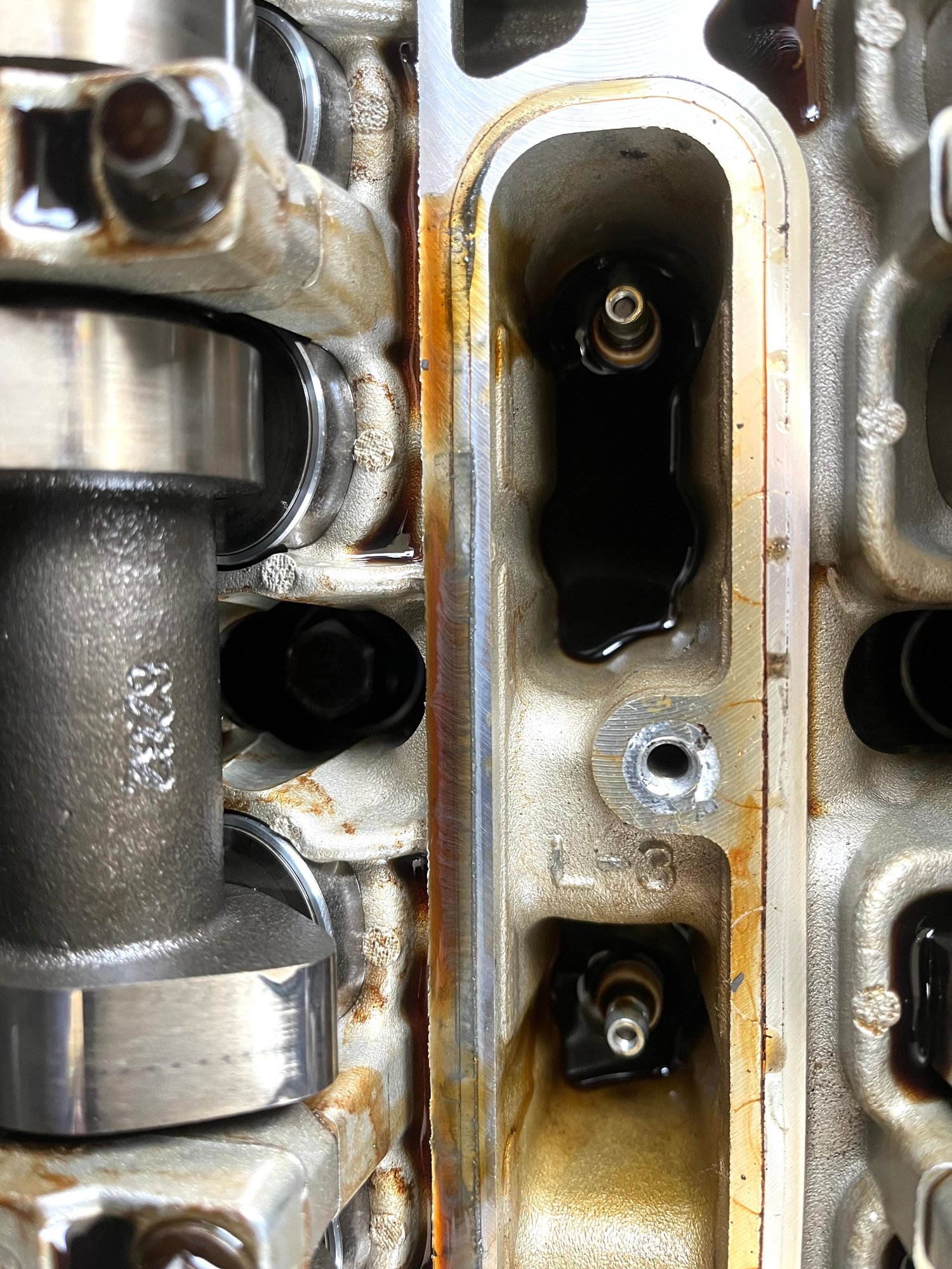

I also noticed the back cam cover (valve cover) is leaking, most definitely the aftermarket gasket seals didn't work.
DO NOT USE AFTERMARKET GASKETS, USE Jaguar OEM gaskets only.

I had the alternator rebuilt as it failed due to oil damage. I replaced the front cover gasket as it was leaking and I will end up doing the rear at a later date.

This is how bad the gaskets were leaking. The oil in the spark plug galley was a surprise.
