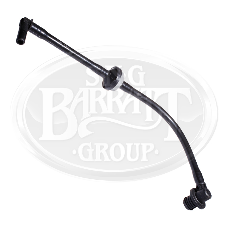

Look over to the right side of this screen and you will find the featured sponsors who sell parts and products. Check out their websites and online catalogs. I suspect you are looking for the vacuum tube that goes from rear side of manifold to the fuel rail pressure sensor. But without full description of what hose you need don't know for certain.

Could this be the part you're talking about? The part number is C2S17552, and I found it on sponsor SNG Barratt's website. They will send you a printed catalog by email request and their prices are reasonable. They also have a download version of the catalog, but I've found the printed version very handy. Once you have the part number it's easy to shop for it. SNG price for this piece is much less than Jagbits for instance. From what I've read about this engine this hose is a common failure item; when it cracks it's a source of additional air, causing a fault code and turning on the CEL.
