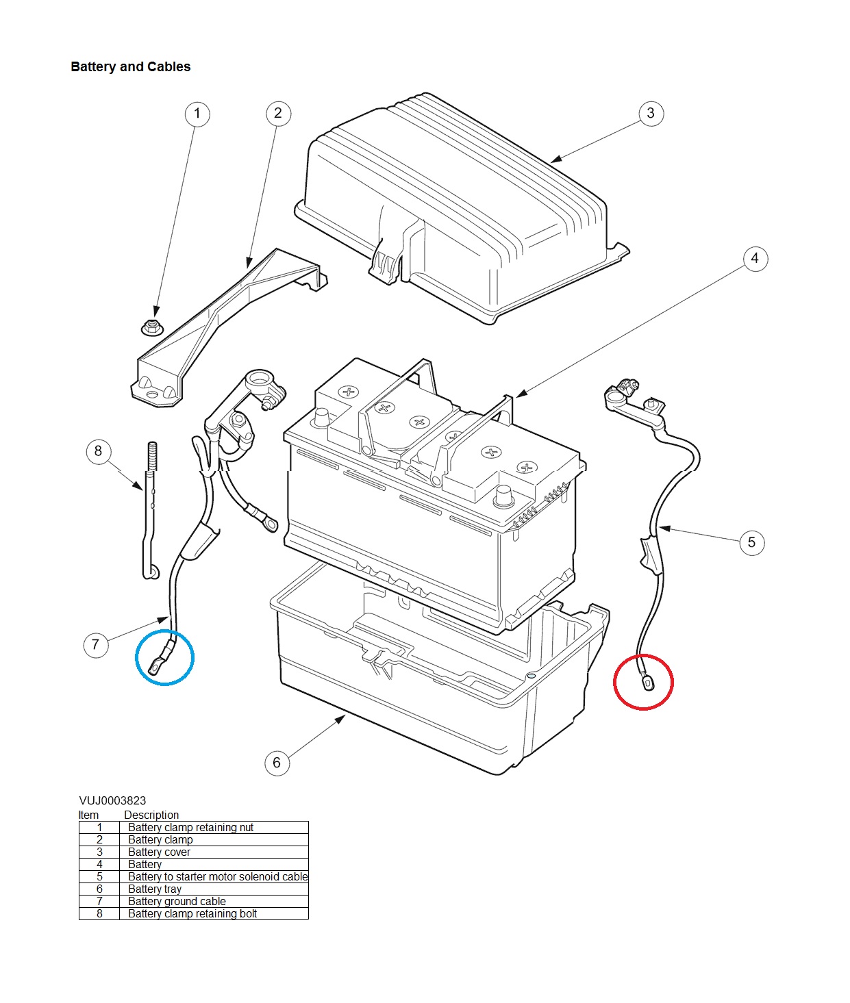

But your current problem sounds to me also like bad battery cables..my 03 did the same thing, but it began with a battery light on the dash after 10 minutes of driving...Replaced ALL the cables with OE type so they'd fit proper (had to search around on the internet to get them all rounded up) and all the little weird problems went away..
Maybe one of the kind Jag Techs here will chime in and get you all the Jaguar Part numbers for the various cables.

Sounds like it..Disconnect the Red lead from the back of the alternator (you have to do this from underneath and with that front splash panel removed..but it's a tight fit for a fat arm)... and connect battery up again..to see if the alternator was your source of a short circuit.
