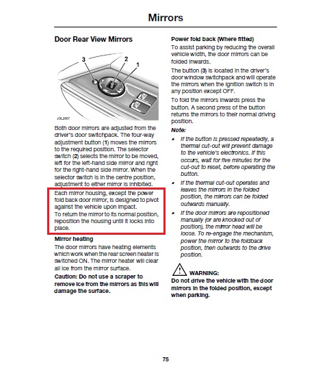

The standard (not Power Fold) mirrors are designed to fold back on impact:
This is to avoid breakage and is NOT intended for use in regular parking.

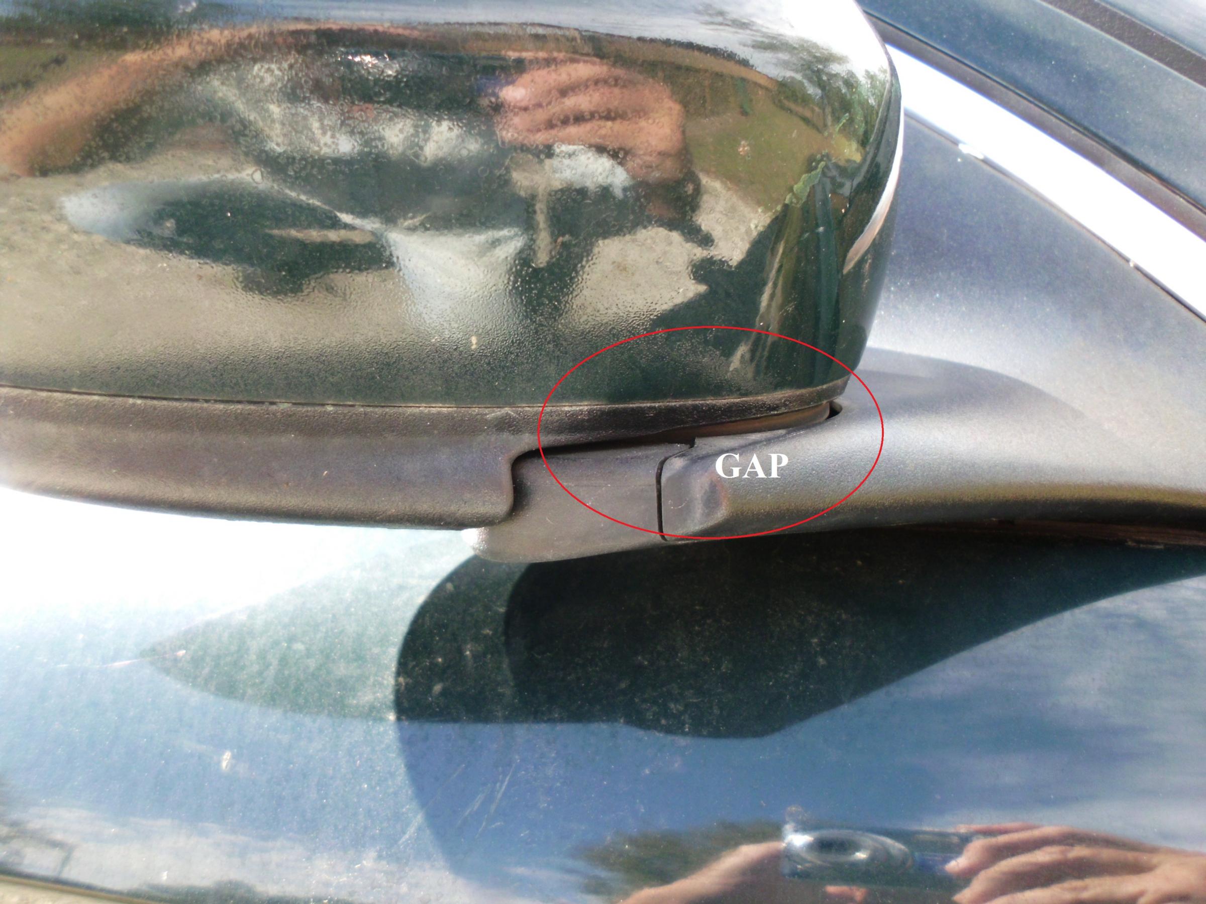

Your mirror swivels are likely just corroded.
Firmly grasp your mirror housing at the far end with one hand and nearest the car with the other. Push the far end toward the car while supporting the end closest to the car. The end closest to the car will "lift" slightly as the mirror swings toward the car. I had to use more effort than I thought I would need before the mirror moved. Lubrication would be helpful as stated above.
