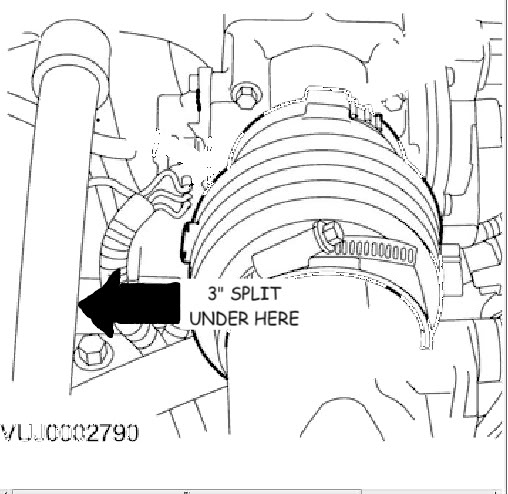

The cruise not available light is most likely a leak from the pcv hose and/or the two seals at the back of the engine on the passenger side on the intake manifold. Check the hose at the front of the engine under the jaguar cover
read my thread (its long) but you will find it ...the thread is
(my x-type projects and installs)
i have a write up on your problem...very simple resolve to your problem
theres photos to help you pin point your problem..were here to help
