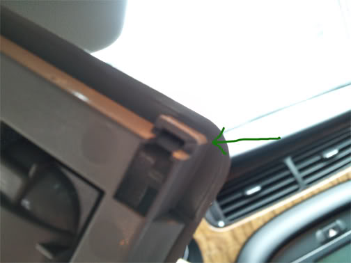

Default Fixed Vanity Cover on Sun Visors 2004 X Type 3.0
I had an issue with the vanity mirror covers not staying up when in use, and when putting the sun visors down to block the sun the covers would drop in the field of view while driving (not good). As mentioned above, all that was needed was a little glue (JB Weld in my case).
1. I started to remove the sun visors from the car thinking it would be easier to fix them on my kitchen counter, but I didn't find an easy way to disconnect the power going to the vanity lights. Perhaps it was further in buried in the roof, but I didn't want to mess with it, and didn't need to.
2. Applying slight bending pressure on the sun visor (on the opposite side of the swing arm) I was able to remove the vanity mirror quite easily*. It'll pop out a little bit out on the side you're applying pressure to, then just pull it out. I used no tools and did this a few times without any issues.
*CAUTION: The there are two small black metal clips that will likely drop out and fall inbetween your seat and your console (which happened to me), and/or fall out your door out on the ground (which also happened to me). Searching for small black clips under your seats or on gravel is not fun, so do you best to not let them fall so you can avoid having a search party.
3. Once you remove the vanity and turn it over you will see on the culprit: cracks in the receptacles in the top corners. Because of the cracks the metal pins that act as the mechanism to hold the cover open/closed will not stay seated. Sorry for blurry pic.Name:  back.jpg
4. Mix up a small batch of JB Weld (or similar product) and apply to the shorter side of the pins (the side with the bumps are the side that insert in the slots). Push the pins in tightly and cover the cracks with JB Weld. Wait to dry.
5. Press vanity mirrors back into place.
