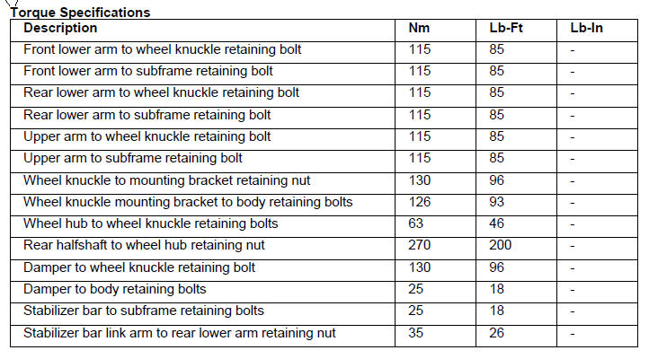

Old Mar 29, 2014 | 12:06 PM
04xtype04's Avatar
Joined: Oct 2013
Posts: 683
Likes: 46
Anyone know the torque specs for the rear shocks?
Old Mar 29, 2014 | 03:50 PM
Paulc732's Avatar
Posts: 608
Likes: 187
From: Lititz PA

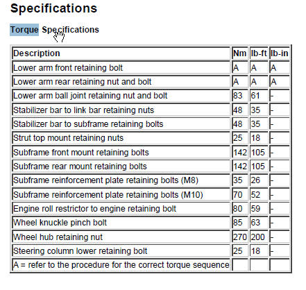

Old Mar 29, 2014 | 04:14 PM
Paulc732's Avatar
Posts: 608
Likes: 187
From: Lititz PA
Default Rear Torque specs
Sorry guys here is the rear.
