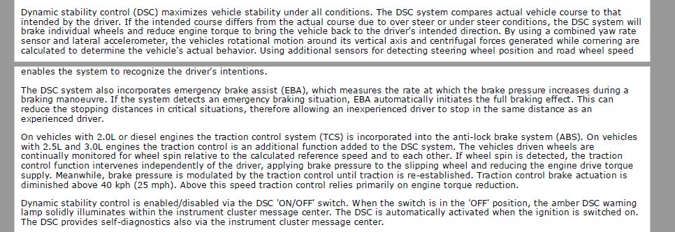

All 02 and 03 will have the viscuous coupling. The newer transfer case wasn't made until 2004. I doubt switching transfer cases will give you DSC. It is an electronic control system. See the attached definition from the shop manual.

right. my question is how do i identify an early transfer case so i can have the viscus coupler. adding dsc is WAAAY to much work.
