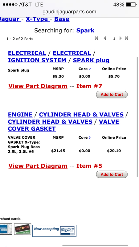

Any recommended spark plugs that I should get I called the Jaguar dealer and they are stating about eight dollars apiece and they are
pre-gapped.
Old Dec 10, 2013 | 05:11 PM
Noxparadise's Avatar
Posts: 192
From: United states
Originally Posted by Noxparadise
Any recommended spark plugs that I should get I called the Jaguar dealer and they are stating about eight dollars apiece and they are pre-gapped.
This good? And what I need?
Attached Thumbnails Xtype OBD codes P0300,P0302,P0306,P1316-image-3978174094.jpg   Xtype OBD codes P0300,P0302,P0306,P1316-image-1672226432.jpg   Xtype OBD codes P0300,P0302,P0306,P1316-image-2291555082.jpg   Xtype OBD codes P0300,P0302,P0306,P1316-image-996085815.jpg   Xtype OBD codes P0300,P0302,P0306,P1316-image-877387235.jpg
