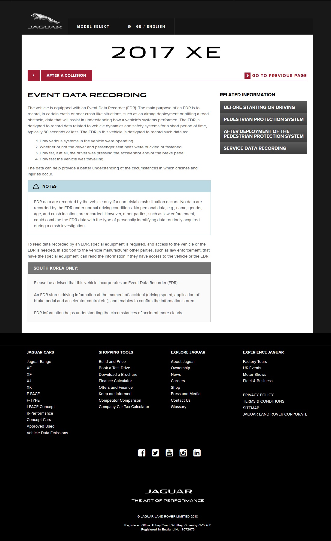

JLR website gives the following information for 2017 XE regarding Event Data Recording in crash situations:
Jaguar Owner Information
Even if you clear the B1193-68 DTC, I'd expect the associated data to be retained unless it is retrieved or cleared with Jaguar SDD. Until this is done, the DTC will just reset because the full storage and lock conditions still apply.
My 2015MY XK has the same system. SDD doesn't show any separate EDR under modules so I presume the data is stored in the RCM.
