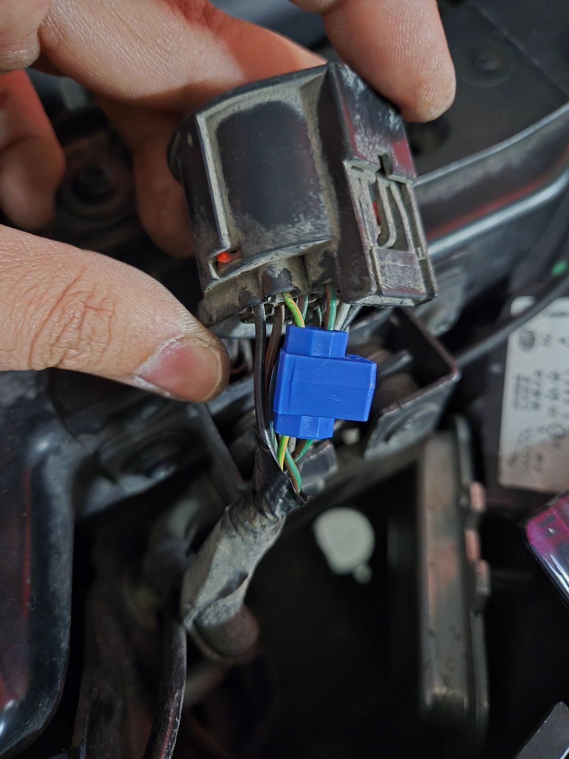

Let me throw some light on this topic:
I have XE 25t MY2017 and it was with halogen headlights. So I decided to buy a pair of Bi-Xenon Headlights and see what will happen. Almost everything is plug and play... except Low beams and DRL's auto turn on.
So... if you want the Low/High beam to be working as it should, you need JLR SDD. You have to enter in Engineering mode and change following paramteres:
-Headlights type -> Gas discharge lights with auto adjuster
-Front low beam profile -> Diagnostic Profil 16
-High beam lamps -> Not fitted
-Xenon lamps are fitted -> Fitted
And for the DRL auto switching on Drive and Revers gears selected, you have just to connect pins 1 and 4 together on the headlight connector.
and this is the result:
Cheers Guys!
