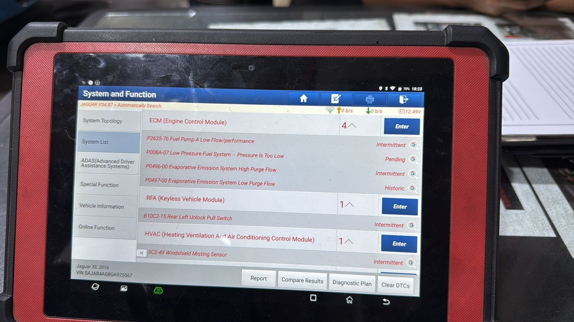

Having issue with my car since October and have been to the workshop 7 times and spent alot to get this rectified
ECM displays the following error codes
P2635-7b Fuel Pump A Low flow/performance Intermittent
P008A-07 Low pressure fuel System Pressure is too low Pending
P0496-00 Evaporative emission system high purge flow Intermittent
P0497-00 Evaporative emission system low purge flow Historic.
Have
replace all this parts, but the problem persists
engine valve cover assembly Engine camshaft Solenoid Exhaust Engine Camshaft Solenoid Intake Engine camshaft sensor Exhaust Engine camshaft sensor intake High pressure fuel pump Low pressure fuel sensor Exhaust Catalytic converter charcoal canister fuel feed pipe and Purge valve Turbo Intercooler Intercooler Intake Manifold Hose Intercooler outlet hose Spark Plug Fuel Pump Fuel Tank Pump O-ring Fuel tank Pump.
Can the expert provide some advice.

Can anyone tell me when the fuel control module is located in this car
