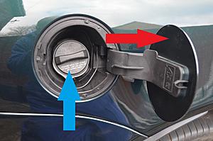

The photo is my XK but the arrangment is similar. If the Fuel Filler Flap (arrowed in red) is open, it will show a warning but not trigger an error code.
If the Fuel Filler Cap (arrowed in blue) is not on tight it can cause the MIL to illuminate but there are also many other reasons why it illuminates.
