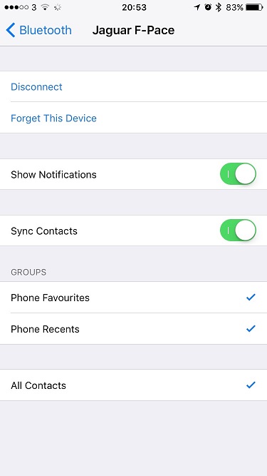

Hello, I sat there for a while trying to work this out for iPhone 7 and 5S with the lack of SMS I was getting through on my F-Pace 8" screen.
First connect the iPhone (either 5S or 7 tested on iOS 10.3.2) to the in-car entertainment system for both music and phone via Bluetooth, no lightning cable required or no Jaguar Apps needed, then make sure you've got "Show Notifications" turned on under the Bluetooth setting on the paired device (in my case Jaguar F-Pace) by selecting the blue "i" in the circle on the far right next to the device in the iPhones Settings > Bluetooth menu.
Once you've done that you MUST go into the iPhones Settings > Notifications > Messages menu and you MUST allow at least "Show on Lock Screen" once set come back out of the Messages menu so the setting takes (lock or don't lock the iPhone it doesn't matter, maybe just press Home) and start sending some test SMS messages to your connected iPhone and see what happens.
See screenshots below, change the Message setting to "Show Preview" to off I suggest, but that's up to you.
Also maybe check the Jaguar App if you have it installed on your iPhone, notifications settings, but they should be good by default, again screenshot attached.
Now all I've got to get working is the ability to "Reply" and "Template Reply" and get the contacts artwork / picture through.
Hope this helps.

Much less effort, though not documented: on the iPhone go to Settings / Bluetooth / Jaguar XF (or whatever you named the car on Bluetooth) and enable the option Show Notifications. No need to mess around with cables first or iPhone notifications (although perhaps these do need to be enabled by default, mine already were).
Now that you mention it, I do not believe that I have ever seen contacts artwork showing. There are other threads about the problems some people have with album artwork... all goes to show that the ICT is currently a work in progress.
Reply and Template Reply are disabled when the vehicle is in motion, as a safety feature. On the positive side Siri is not too bad for dictating messages.
