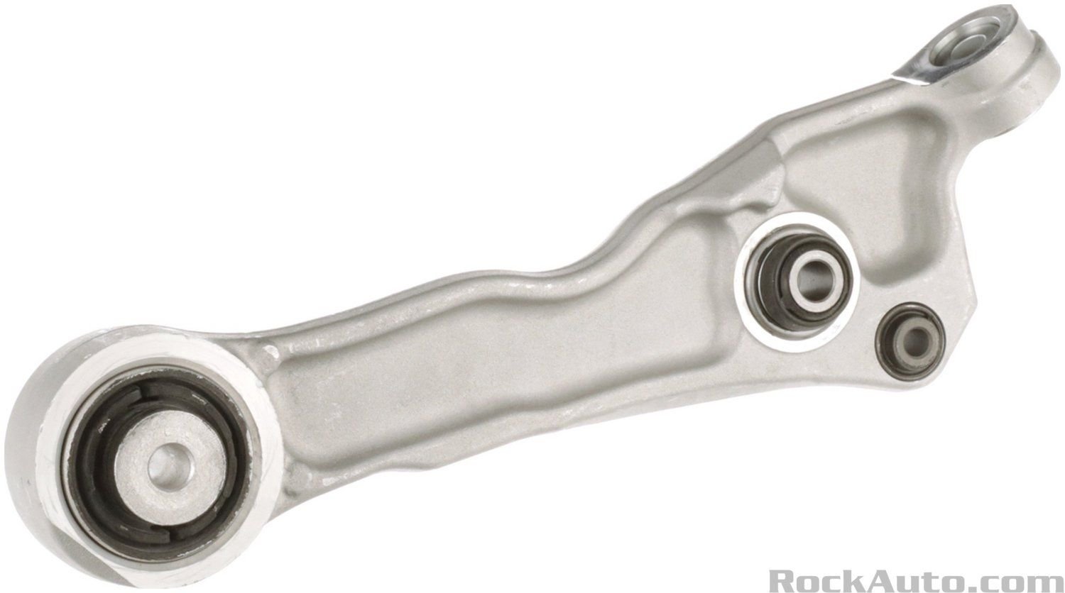

My first suspects would be the front lower control arm (LCA) bushings. As the rubber softens, deteriorates and cracks, they lose their ability to maintain proper steering geometry. The front wheels can wobble independently from side to side in response to road imperfections, accelerating and braking. You will typically notice this effect most when braking from high speed, such as on a highway exit ramp.
Have your shop inspect the front suspension bushings visually and while prying on various suspension parts with a long bar, which will often reveal softness or cracks that aren't apparent just by visual inspection.
Here's a photo of the front rearward LCA that clearly shows the three black rubber bushings:
The front forward LCAs have two bushings, and the upper control arms (UCA) have two bushings and a ball joint. We typically only get about 10 years out of the rubber bushings.
