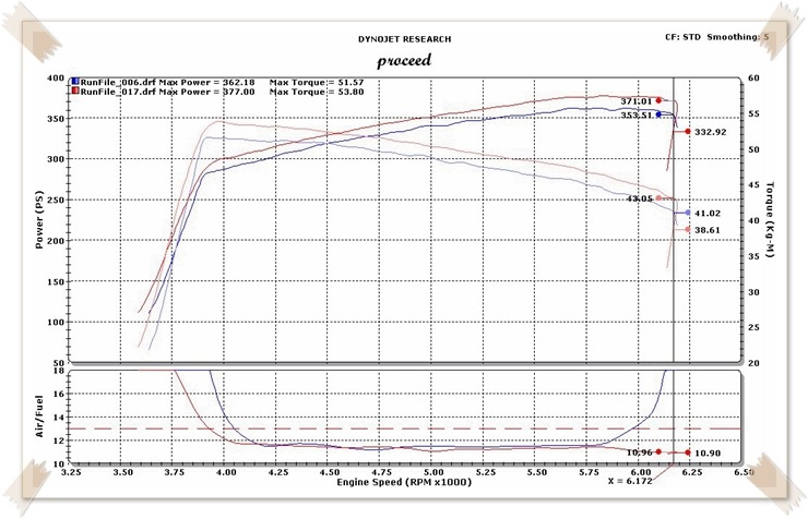

1. stock :
362.18whp / 51.57 torque (kg/m) .... engine hp => 420
# loss power : 16%
2. upper pulley upgrade & sports exhaust ( muffler )
377 whp / 53 torque

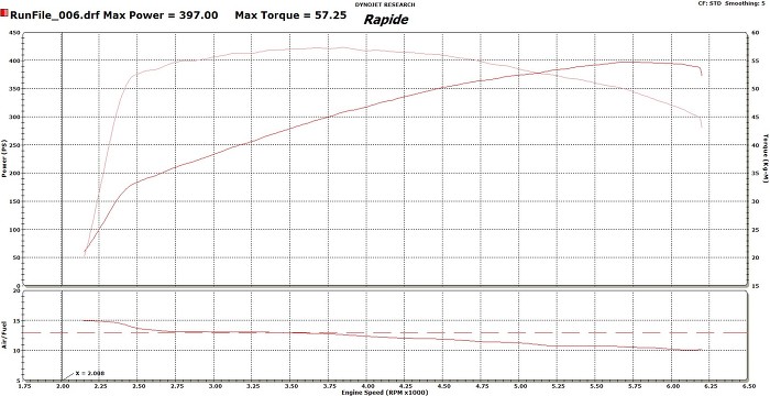

3. "2" + sports catalyst (200cell) .. ecu mapping (with remove speed limit)
397 whp / 57.25 torque
# I think my car loss about 16% of engine power
therefore, I guess now about 460 hp ..

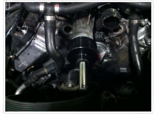

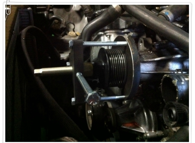

I bought a pulley puller from e-bay
With this kit, I can easily remove & install pulley

Great results my friend and thank you for sharing your results, 397whp is the highest figure I've seen on a 4.2 supercharged engine with the Eaton M112 which I'm assuming the XF also uses. What brand high flow cats did you use as I'm thinking of getting some and who did your ecu tune? How does the car drive after the modifications?

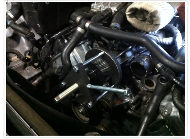

Can anyone confirm if this puller would work on the 5.0 supercharger pulley...
This pulley puller will not work on any Jag. I think the poster took a screen shot of the wrong one. That puller in the pic is for M62 and M45 Eaton which is Mercedes. On there website they do have a puller for the Eaton M112 and M90 which is Jaguar 4.0 and 4.2 engines. The Jaguar 5.0 has a Eaton TVS R1900, I'm not sure even if you bought the right pulley puller that it would work.

Originally Posted by cby210
Eaton M90/M112 Pulley Puller & Installation Tool
Above link item is same as mine
Attached Thumbnails 2009 XF 4.2 sv8 .. Dyno result-q.jpg   2009 XF 4.2 sv8 .. Dyno result-qq.jpg   2009 XF 4.2 sv8 .. Dyno result-qqq.jpg

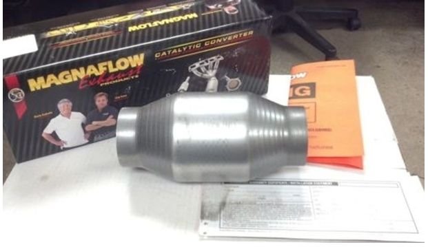

I bought magnaflow cats which have 200cell
ECU tune... It's long story..
1. Dynatek .. can't remove speed limiter
2. Revo .. can't remove speed limiter also, and improper tune
( result : engine blow so, I have to buy new engine )
.. because of excessive ignition advance about 6 degree ..
3. custom tune .. KOREA .. remove speed limiter & nice result .
after modification : more powerful & better response.. I like it
yes, you are right .. I mistook to attach photo..

Did the magnaflow CATs make the exhaust a lot louder? I'm also running the Mina sport mufflers so I'm guessing it would be a similar sound to your car if I upgraded the CATs too. Do you have any problems with drone at all?
Crazy what happened to you with the Revo tune, I thought they were a reputable company. I guess they're comfort zone is more with VAG vehicles though.
I attach photo & sound..
I couldn't link my car sound..
Please click "Xf 4.2 sv8 exhaust sound - You Tube" <== below box

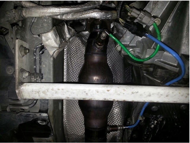

Upgrading cats don't have any problem..
- Just think this -
Don't use 90 degree angled O2 sensor spacer which prevent to O2 check engine light.
Someone want to install 200cell sports CATS, they usually install O2 sensor spacer to prevent O2 check engine light (because stock CATS have 600cell. so O2 sensor detect different voltage)
But our XF stock O2 sensor is installed in the middle of CAT, so If you install O2 sensor to the end of upgrade CATS. the O2 sensor location can compensate 90 degree angled O2 spacer
