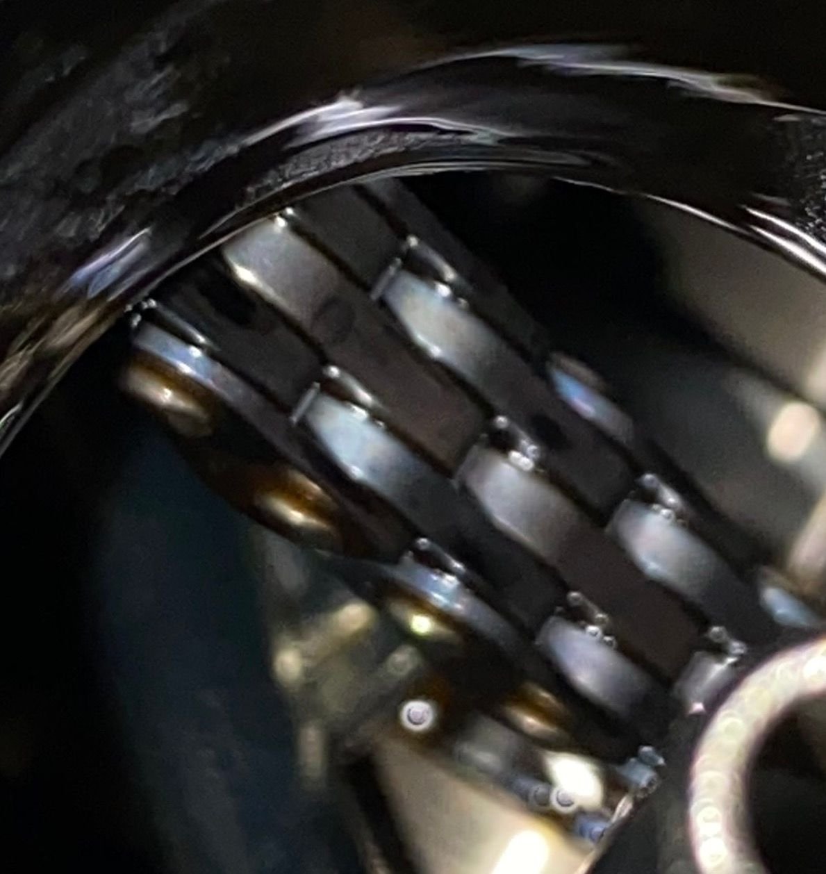

Originally Posted by prolepsis
Interesting. I went to the basement for a quick look at my 2011 5.0 n/a. What I saw seems like the 8mm INA chain. It definitely doesn't look like the 6.35mm Tsubaki chain. Would you agree? Sorry for poor quality photo.
Yes 8mm. 6.35 is wider with more link pieces.

Here is another comparison photo of the two chain types. 8mm is top one. Personally I think the 6.35mm setup is much higher quality and probably replaced because of cost-cutting rather than unreliability.
