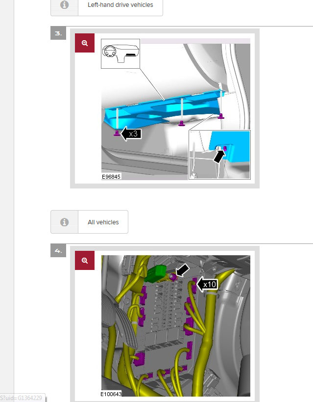

You mentioned changing fuses - did you check the correct ones? See attachment of wiring diagram. Fuses are located in Central Junction Box.

I've just had my drivers seat fixed as it had lost all button controls to adjust it including the door memory options. After several hours with my local jag specialist the fault was identified as the seat control unit. So replacement unit in and we were up and running. Final cost £490.00 + VAT. I love Jag repair bills they make my day....
