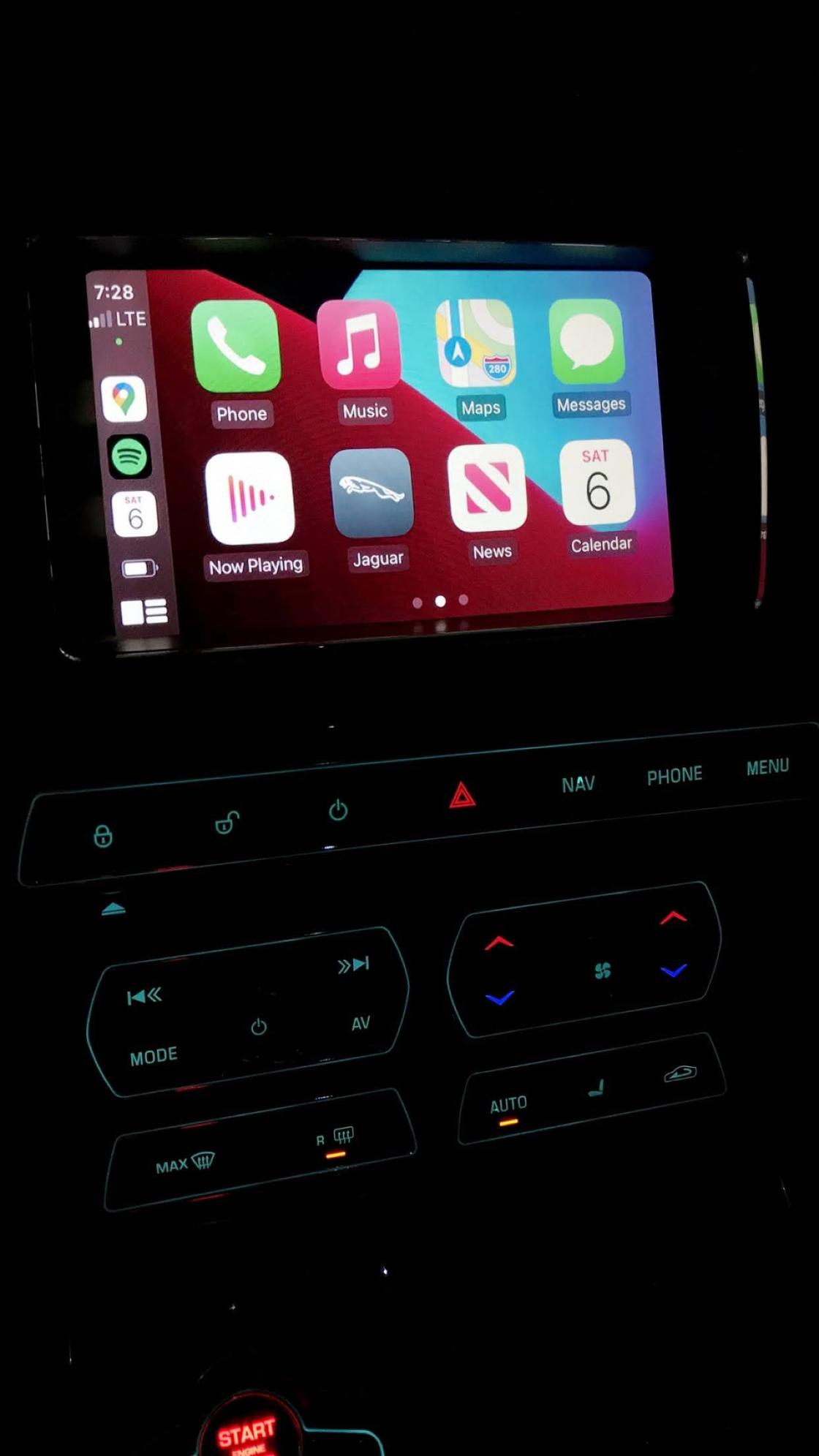

Thanks to H.Jones and a couple of videos I found on Youtube, I found out about the Apple CarPlay/Android Auto compatibility for MY 2012-2015 XFs. I researched other forums and found that these two units received the most reviews:
https://unique-ad.co.uk/product/wire...-xf-2011-2015/
https://www.aliexpress.com/item/1005...7da14c4dwKYZTU
I went with the Joyeauto unit as it had many reviews from Audi/BMW/Porsche forums and it was significantly cheaper. Seller was prompt in answering questions and I received the unit within 7 days. Installation was a breeze, all the tools you need are a plastic trim tool, T20/T30 bits, and a screw driver. The unit is plug and play and in total it took me 2 hours to finish the job at a leisurely pace.
CarPlay works wired or wireless and I found both to be seamless. This really modernized the car and makes it much more enjoyable to commute in, highly recommend!

Everything else on the stock infotainment works as expected except for NAV. When you press the NAV button or NAV on touchscreen, it goes into the CarPlay/Android Auto UI. Reverse camera works just like factory, automatically comes up when you put the car in reverse. The Joyeauto unit is connected to the car audio through an aux cable, so you have to switch the audio input in the car to aux. You still have volume control, but you cannot skip music through steering wheel controls. Your phone will be connected to the Joyeauto device via wifi/bluetooth, but it still has to be connected to the car bluetooth for the phone function to work.
So it's not a perfect setup, but the ability to browse Spotify, Listen/Respond to Messages, get Waze on the screen is well worth the quirks.

There were a few occasions where the screen rebooted and CarPlay wouldn't automatically connect wirelessly. But nothing major and it runs smoothly 95% of the time.
One other thing, because the touchscreens are hopelessly outdated, swiping the screen left/right or up/down is not smooth and the icons need a bit more touch effort compared to regular iphone/ipad screens.

CarPlay is restrictive in terms of what apps show up. Might be a possibility through Android Auto, but not sure. The module does have a screen mirroring option, so you can have a setup where you have a Wifi based OBDII reader, which sends data to an app such as DashCommand and mirror that onto the Nav screen. But, you lose CarPlay/AA when screen mirroring is enabled.

For that level of seamless integration, you would need a complete custom setup. A new head unit possibly, wiring to read and transmit engine diagnostics to the display, and coding to retain factory head unit functions. Easier solution would be to mount an ipad mini or a cheap phone above the dash, connect it via Wifi to the OBDII reader, so you get both the original display and engine diagnostics without the complexity.
