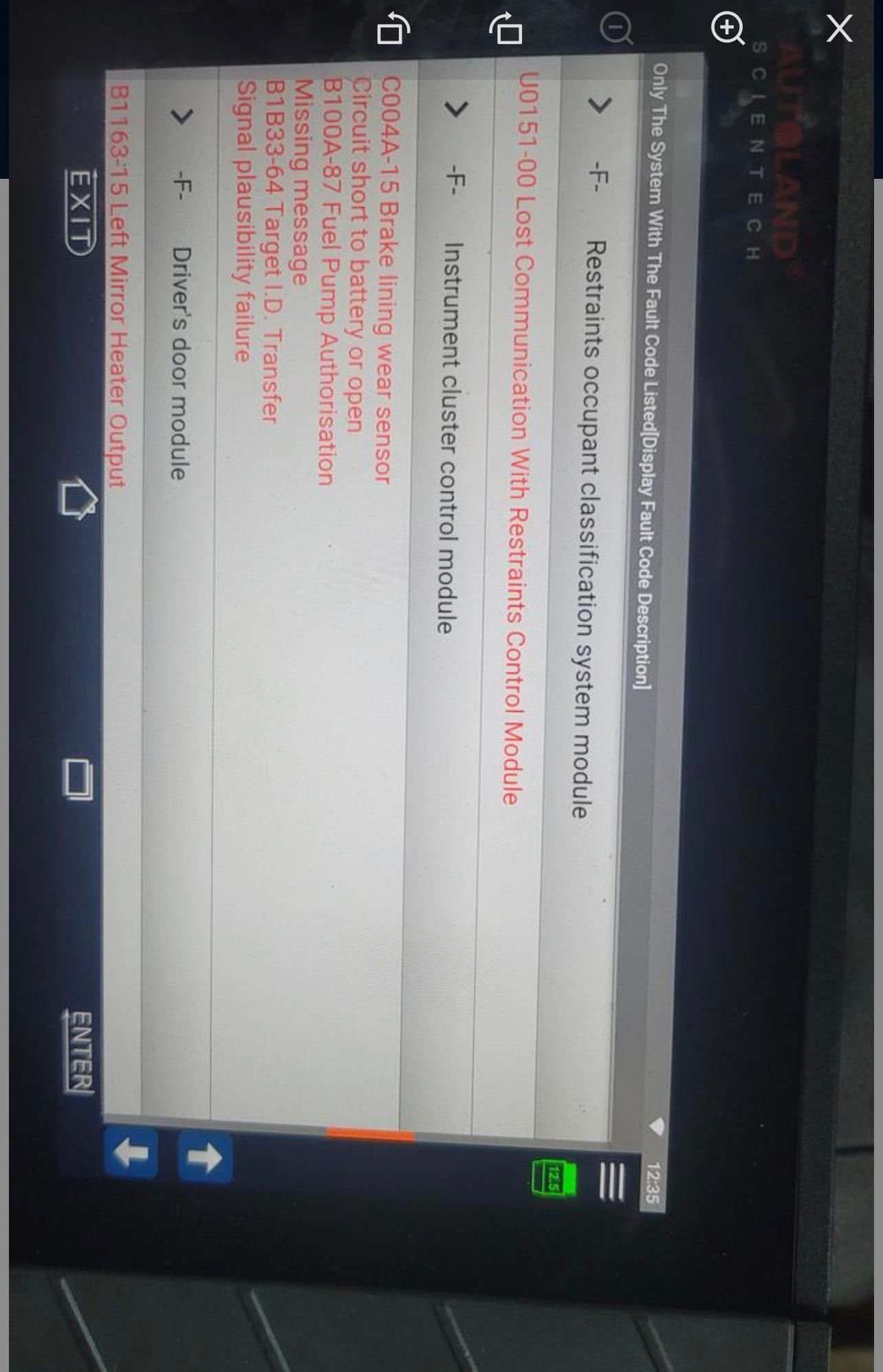

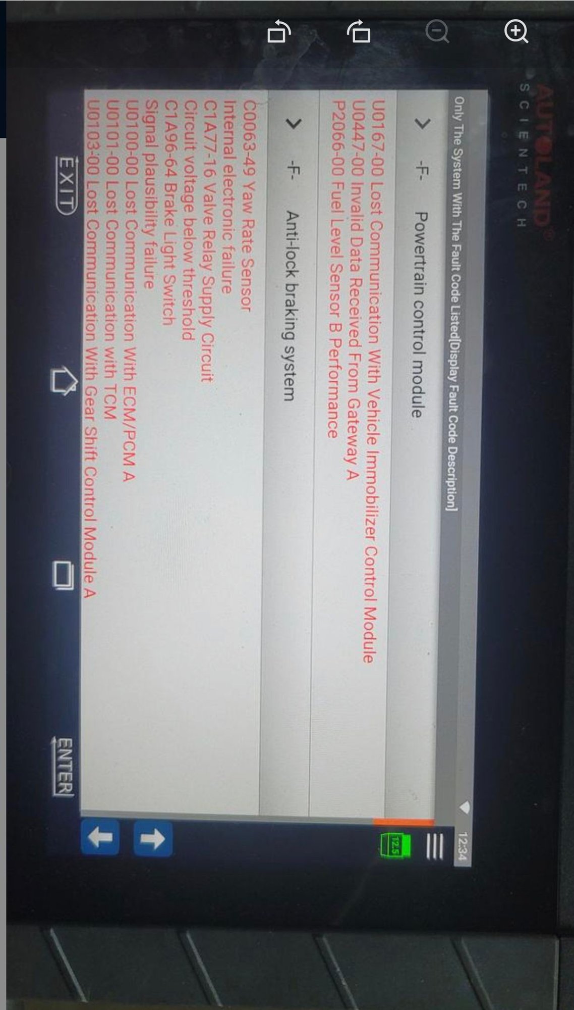

My car is in the shop now getting fixed, atleast ik now what was going on with the crazy car 🤦‍♀️
I attached pictures in case someone else has the same problems
