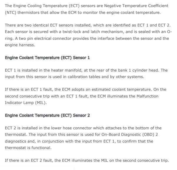

I recently sold my 2013 and got a 2014 with only 36k miles on it. The dealer had done the y-pipe repair which made me feel better about purchasing it. I got a check engine light a couple weeks ago and it threw a p2183 which is the coolant temp sensor #2. Can anyone tell me where it is located and how hard it is to get to it? I wanted to check the connector first to make sure the dealer may have not reconnected it very well or it got dirty or something making it not read correctly. I cleared the code and the light has been off but it has a permanent code set. I've noticed the car doesn't shut off as often as I'd expect and wonder if related to that sensor not reading properly. I hope this isn't a case of "remove the supercharger" just to get to it.

Thank you for sending that info. My light has remained off since I cleared it but when I scan, it shows that code and permanent stated. I've read a little bit does that mean the car detects issues with the sensor on occasion so won't clear itself and why I might have intermittent eco mode occurrences?
Is the lower hose connector and thermostat referenced on the front and easy to access from above or have to take off belly pan and get to it from under? I keep finding stuff related to the 5.0 and assume not the same for a 3.0.
I have found the connector I believe but looks untouched. Not quite sure how to troubleshoot and might be worth just replacing. My fear is since they did some y pipe work and had supercharger off, did they not get something re-connected related to the sensor 1 and is the true source of the discrepancy? I'm not exactly sure why I don't have a MIL lit now and the permanent code is there.
