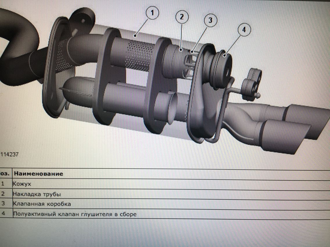

Here's a diagram I found on-line many years ago, sorry it's in Russian, the valve is parts 2, 3 and 4 so those are what needs to be cut out.

Thanks for the info. I found an English version on this forum in the XF docs which are shared.
I think we are going to go for the standard XFR rear boxes, at least it is a potential improvement (looks and sound) over the stanrdard XF oval pipes and passive rear box. From there we can see how it goes.
