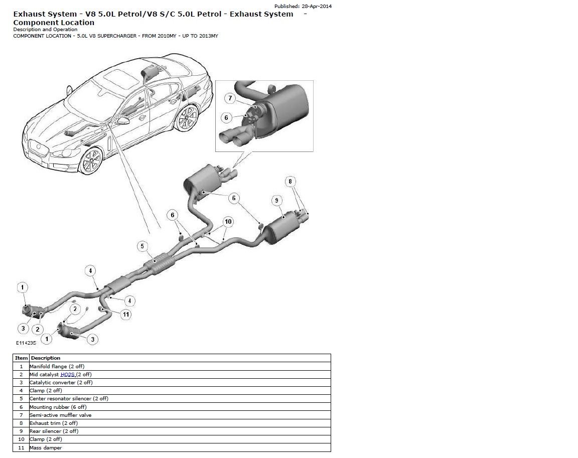

You probably don't know this over in the States. Jaguar sold 50 XFR's in the UK that were fitted with the Quicksilver system back in 2010. They were named Le Mans special edition. I have one and can say in all honesty that there is no drone whatsoever at any speed. The sound is glorious and a real head turner.
Here's a diagram of the standard XFR system so you can see things.
