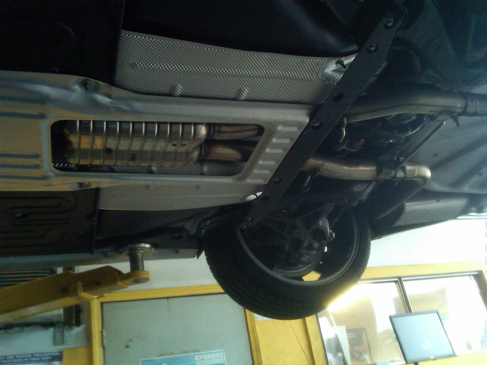

Which did you buy for the install and which tips did you use? Any pix of the under neath so we can see your install please?

Pretty sure I got the VMK10-250 and then brought my own tips from a speed shop. They fit nicely with wiring into spare wheel well and wired into ignition from the fusebox in the trunk. Done with original system left intact for when I sell the car.
Attached Thumbnails XF Exhaust comparison test done.-1329432029444.jpg   XF Exhaust comparison test done.-1329432104940.jpg
