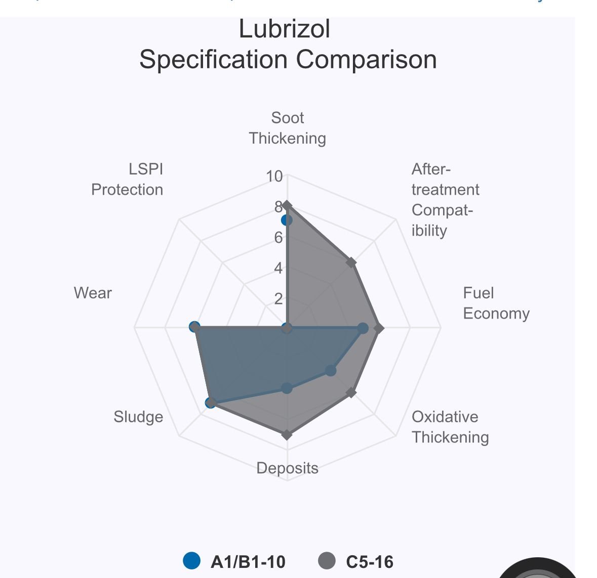

Originally Posted by l.clay.collins
I wondered why Jaguar reduced the oil viscosity in my 5.0 XF from 5w20 to 0w20. It certainly makes sense now. I just thought it was for fuel economy. Too bad our cars don’t have temperature and oil pressure gauges.
old 5w20 was an acea a1 which is obsolete. new one is c5 oil. c5 oils are held to a much higher standard for long life intervals than old a1.
the reason for using a 20 oil is because it provides non-negligible fuel economy benefits. the whole 2009 technical guide is just a laundry list everything they did to reduce parasitic loss and increase fuel economy.
the difference between the old a1 and new c5 oil when it comes to chain wear is when you’re doing factory drain intervals. biggest problem on a 2012 is the tensioner to moving guide metallurgy being wrong, they run out of adjustment well before the chain is worn out.
