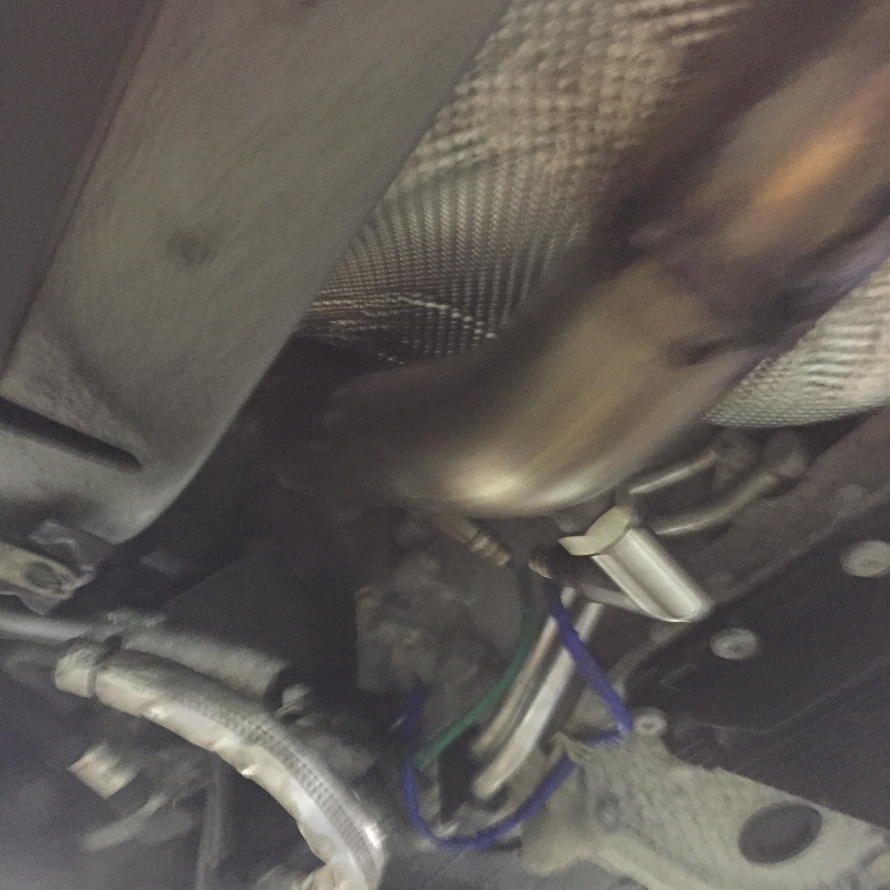

Here us a pic to give you an idea.... This worked for my cat delete... Had a CEL light on for a bit ...but it was just a pin hole in the weld.... Had to drive for a bit of cycles to get a passable MIL status for state inspection .

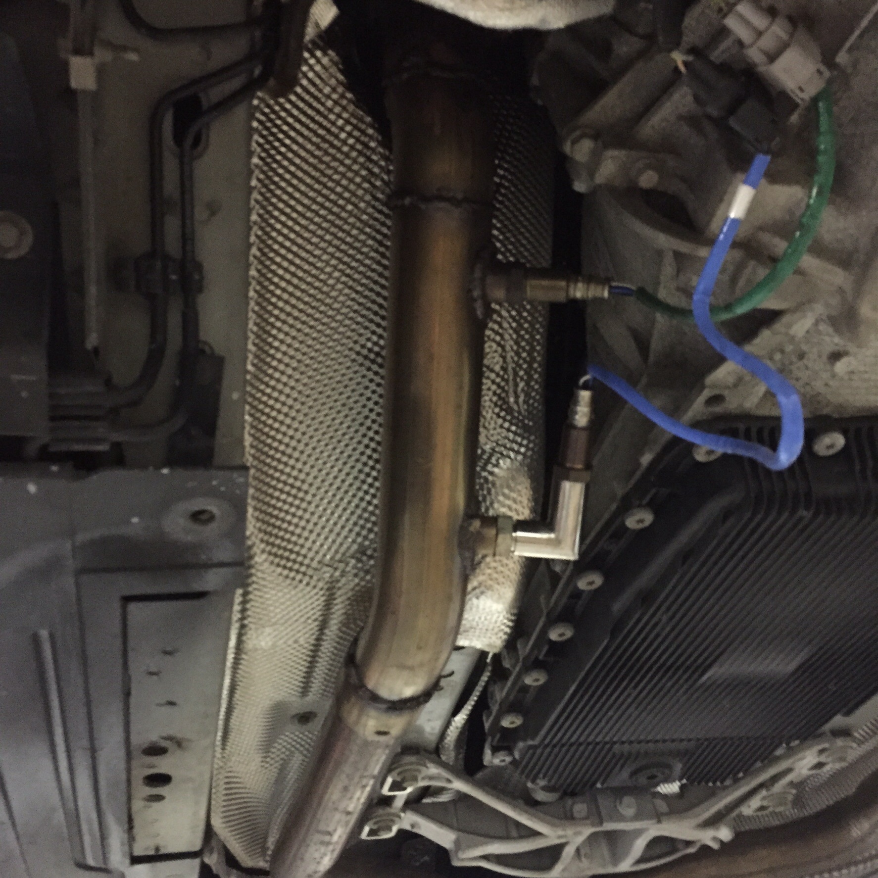

Here's another .

That's pretty much the same as mine except I move the sensor a little further down stream.. I drove for a while and upon several shut downs and start ups it cleared the light.

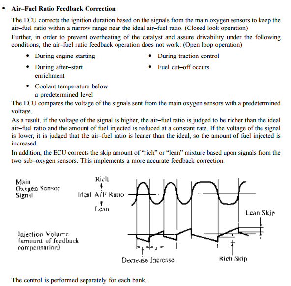

Yes it's true that the downstream sensors are also used to manage fuelling, they are not only for monitoring catalyst performance.
On the Jaguar engines this has been the case since the AJ-V8 was first introduced in 1996. And it applies to all vehicles since.
Trying to find a proper explanation is not so easy, but I did get something from a Denso document (the Jaguar gasoline engines used Denso ECU's up until around 2013 when they switched to Bosch, it also applies to the Bosch cars).
So this is it:
Basically the downstream sensors are used to control the "skip" which is like an over or under correction when there is a rapid change in the AFR.
Which is why the slow &/or incorrectly reading downstream sensors create problems. Some more info in this thread https://www.jaguarforums.com/forum/x...-remap-140980/
You can see the dyno charts with the AFR plots in that thread, also the pictures of the "minicats" or extensions which we took off the car.
The best way to solve P0420 & P0430 code problem when running high-flow or even no cats is to change the emissions setting of the ECU to the Euro 2 standard which disables the catalyst efficiency monitoring. This way the downstream sensors are still accurately measuring the oxygen content of the exhaust, and the fuelling "skip" correction is not affected.
Next option is for the P0420 & P0430 codes to be disabled in the ECU, most tuners can do this with their tuning software. The ECU still detects the "fault" with the cats but no longer sets the code or the CEL.
The minicats or extensions are probably the cheapest option because nobody has to touch the ECU, but you are no longer getting the correct fuelling because the sensors are simply not reading correctly.
Likewise for these "O2 sensor simulators" which are wired in between the sensors and ECU, you are giving the ECU wrong information. And it will adjust the fuelling based on wrong information.
