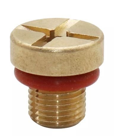

Is this the right one? None of them mention the thread size so it's hard to tell.
Brass Bleed Screw

Thanks but your picture is the 4.2L engine and I was talking about the later 5.0L engines.
But the one I linked to up thread is the correct one for the later 3.0 and 5.0 engines. It does NOT fit the 4.2L engines.
Unfortunately as posted above if you have that engine Jaguar requires you to buy the entire top reservoir tank to get the bleed screw.

OK but there are all kinds of replacement bleeders like I posted above.

I found the right one on ebay, the problem is they are selling 2 different sizes under the same part #, gotta ask the seller to
measure it.
