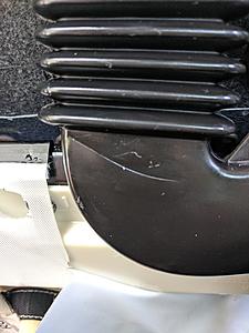

Default Fixed the one behind the driver's side the passenger one was fine.
I put duct tape (the stuff you put on AC ducts) it worked easily. I didn't have to remove any of the zip ties. Just unscrewed them as in above directions, pulled it out and examined them. Put the duct tape on and then reinserted. Back is nice and cool. Need to check the ducts underneath the seat though, but they work okay.
