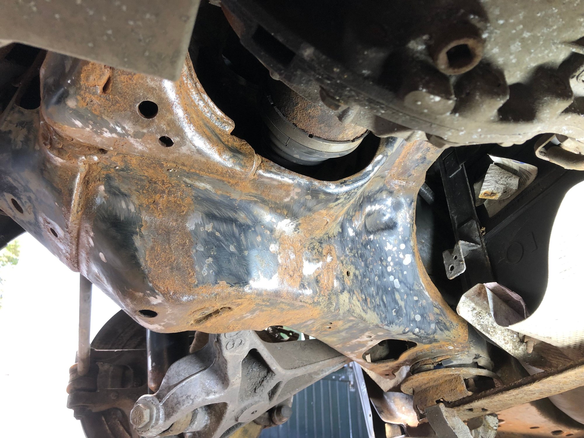

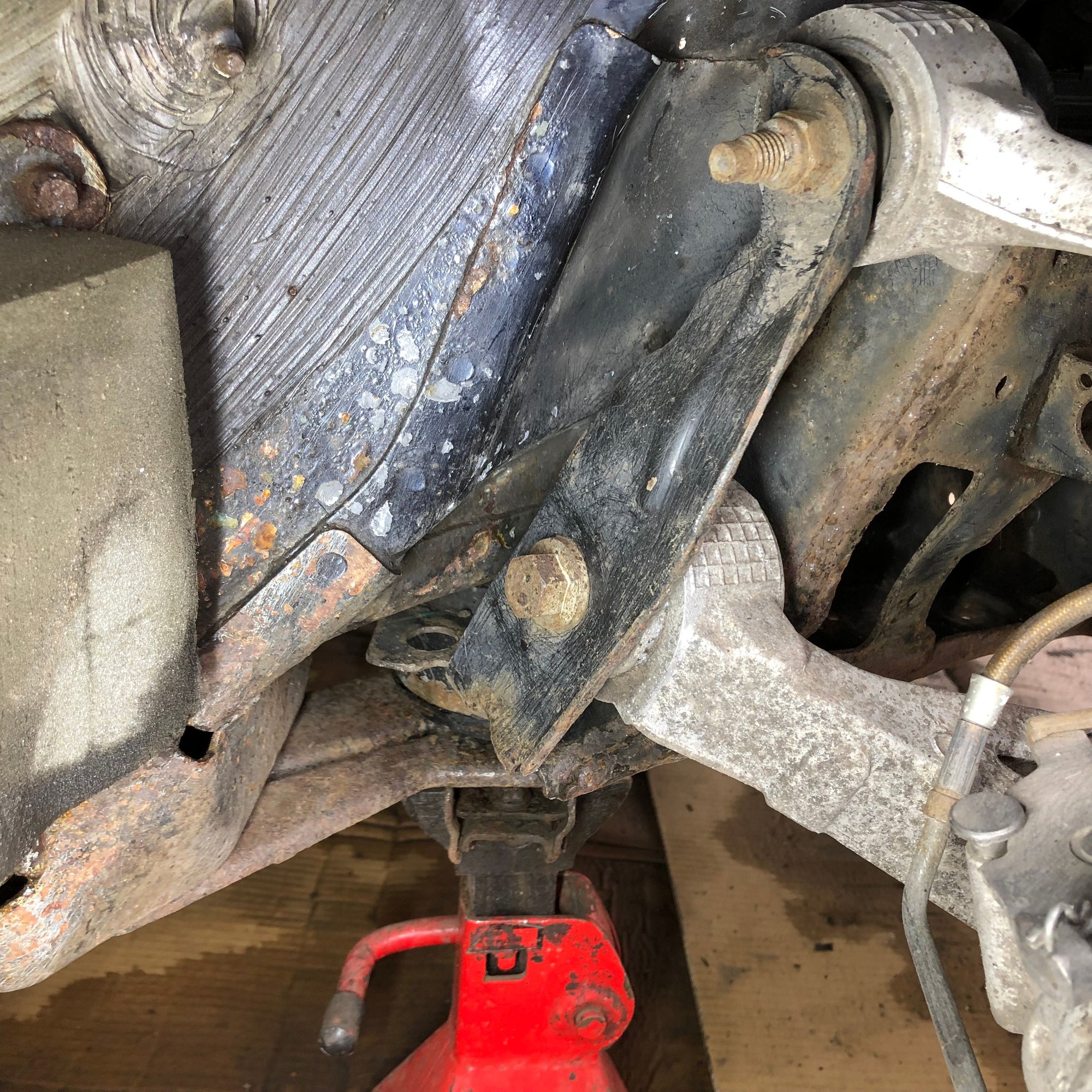

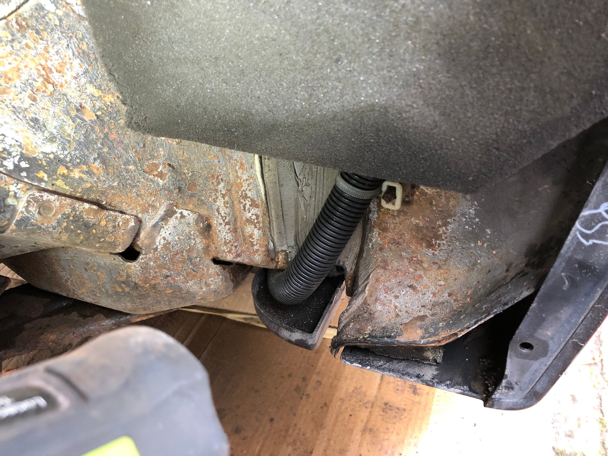

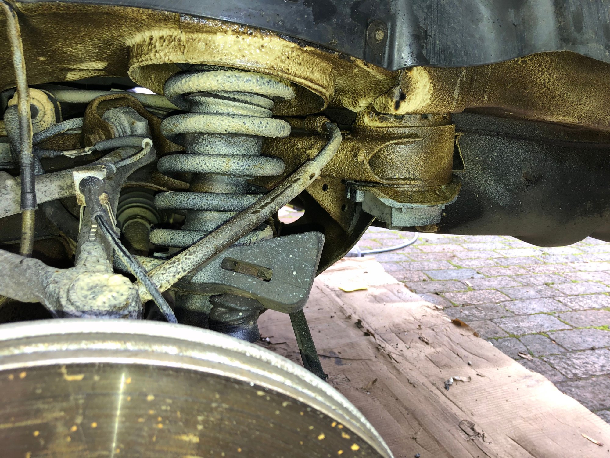

Hi,
My 2012 model year XF with 129,000 miles just got an advisory for rear subframe and chassis corrosion on the MOT, i was surprised and thought the tester was a bit overzealous but at the weekend i got it jacked up and had a look.
I got the wheel arch liners out and cleaned everything around the subframe, mounts, wheel arch (body side) and sill closures, after 5 hours with a soft wire brush, then jet wash and I was quite surprised at what i saw. The subframe is a very complex fabrication of pressing and welds and it only has a light coat of black paint, no other protection, the exposed areas and around the welds had have surface corrosion, some pitting and scaling but nothing that could weaken it. Inside the wheel arches on the body side the only protection was body paint and seam sealer, even on the end of the sills and a re-enforcing section underneath so the paint was lifting with surface corrosion underneath.

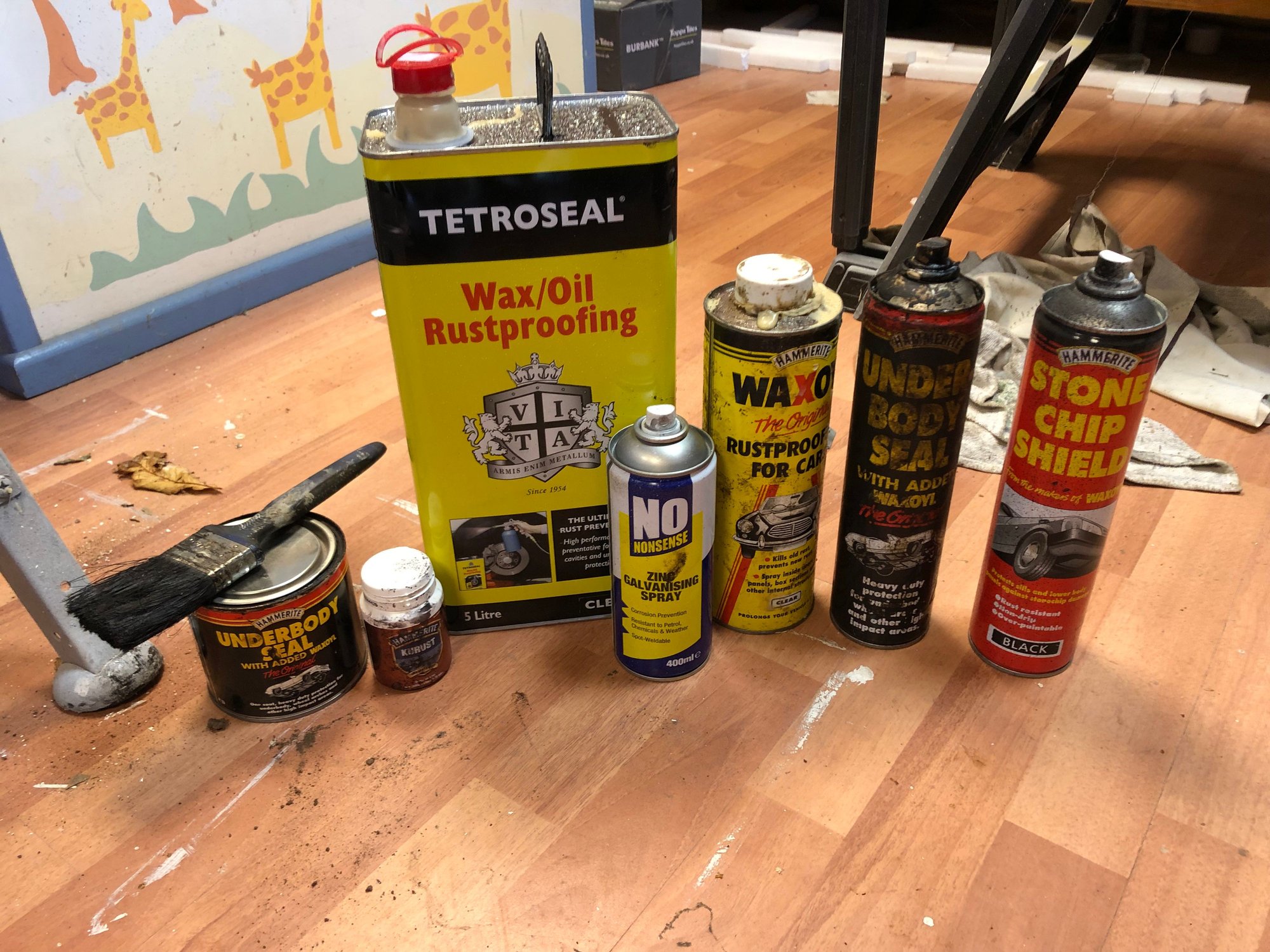

The next day i spent another 4 hours with a wire brush on a drill and a paint and corrosion removal wheel, on the subframe it was difficult to get to all areas which is why it took so long. Now i have coated it all with rust converter, next weekend will be zinc primer, stone chip / chassis paint, underbody wax and cavity wax in the sills.
I would seriously recommend getting your cars cleaned off underneath and sprayed with corrosion protection. My 20 year XK8 has had this done a couple of times and has no rust, my 1993 Mazda MX-6 has much better factory protection and is in much better condition than this XF.
See pictures below. I will post more next weekend.
After soft wire brush and jet wash, sill end and body mounting points for subframe. Off side
near side suspension mountings after light cleaning.
sub frame after heavy scrubbingl
Another view of the subframe after heavy scrubbing.

This does happens when snow is present in the area where you live and the road then sprayed with salt (sodium chloride & magnesium chloride) as an anti-icing measure. Or maybe you live in an area nearing the sea/ocean shore where salt is present.
What you did was excellent by applying (copied & pasted from OP) rust converter, next weekend will be zinc primer, stone chip / chassis paint, underbody wax and cavity wax in the sills.
Now, to prevent this from ever happening again even if you do not have snow but constant rain all year round, when spring has arrived, do a yearly underbody wash using a water hose or a water pressure if you have one and make sure the dirt, dust, mud and road grime that may have already accumulated that are stuck on the frame on the vehicle are gone. Run your fingers and a water hose to the spot where there are hardened mud or grime especially the underside & wheel mud guards have accumulated.

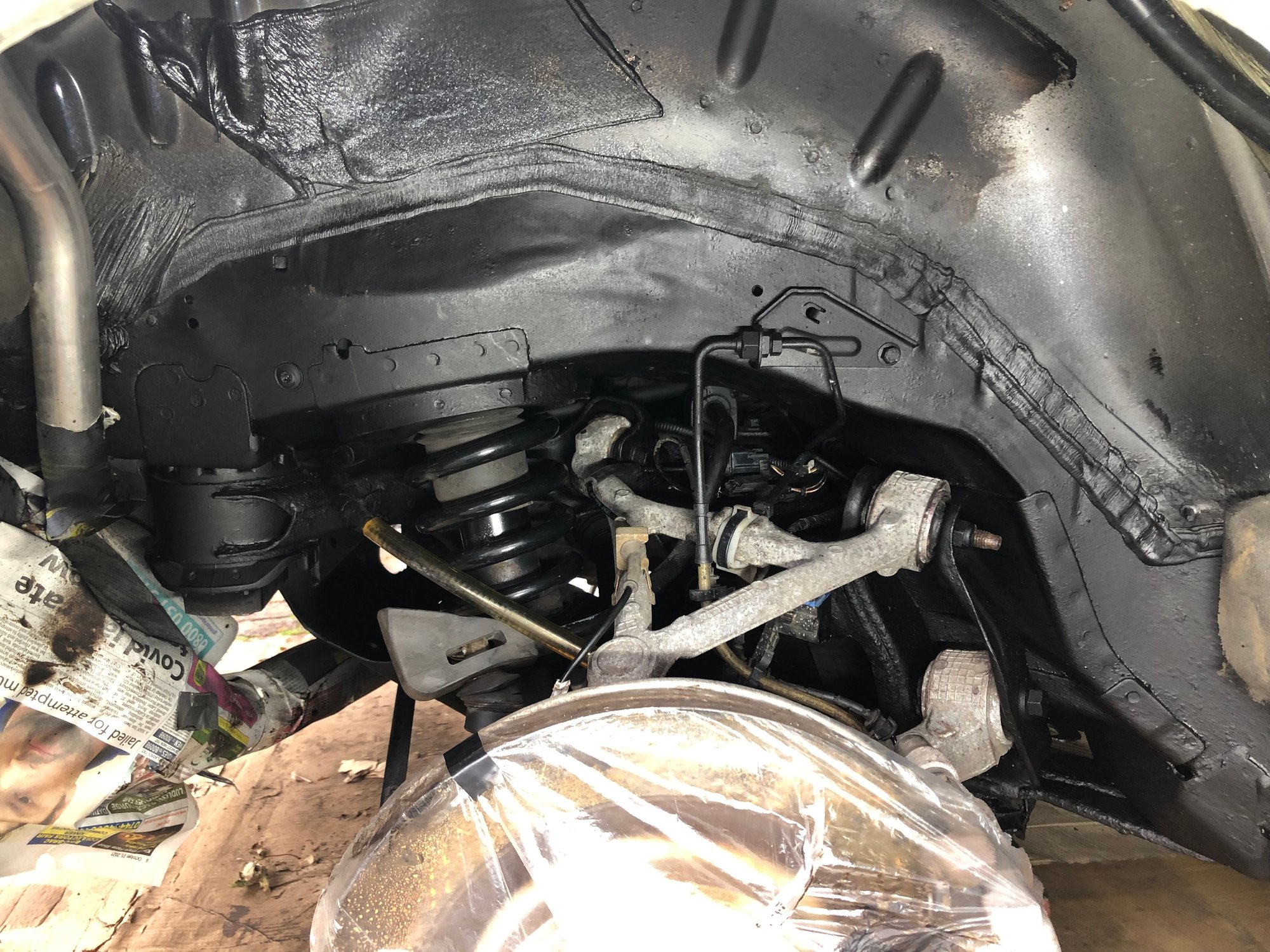

To answer the question first. I’m not near the sea, I’m in the Midlands so as far as I can be in the UK. Also I keep the car clean and hose under the wheel arches when I wash it, I don’t service it myself though, if I did I would have seen it sooner.

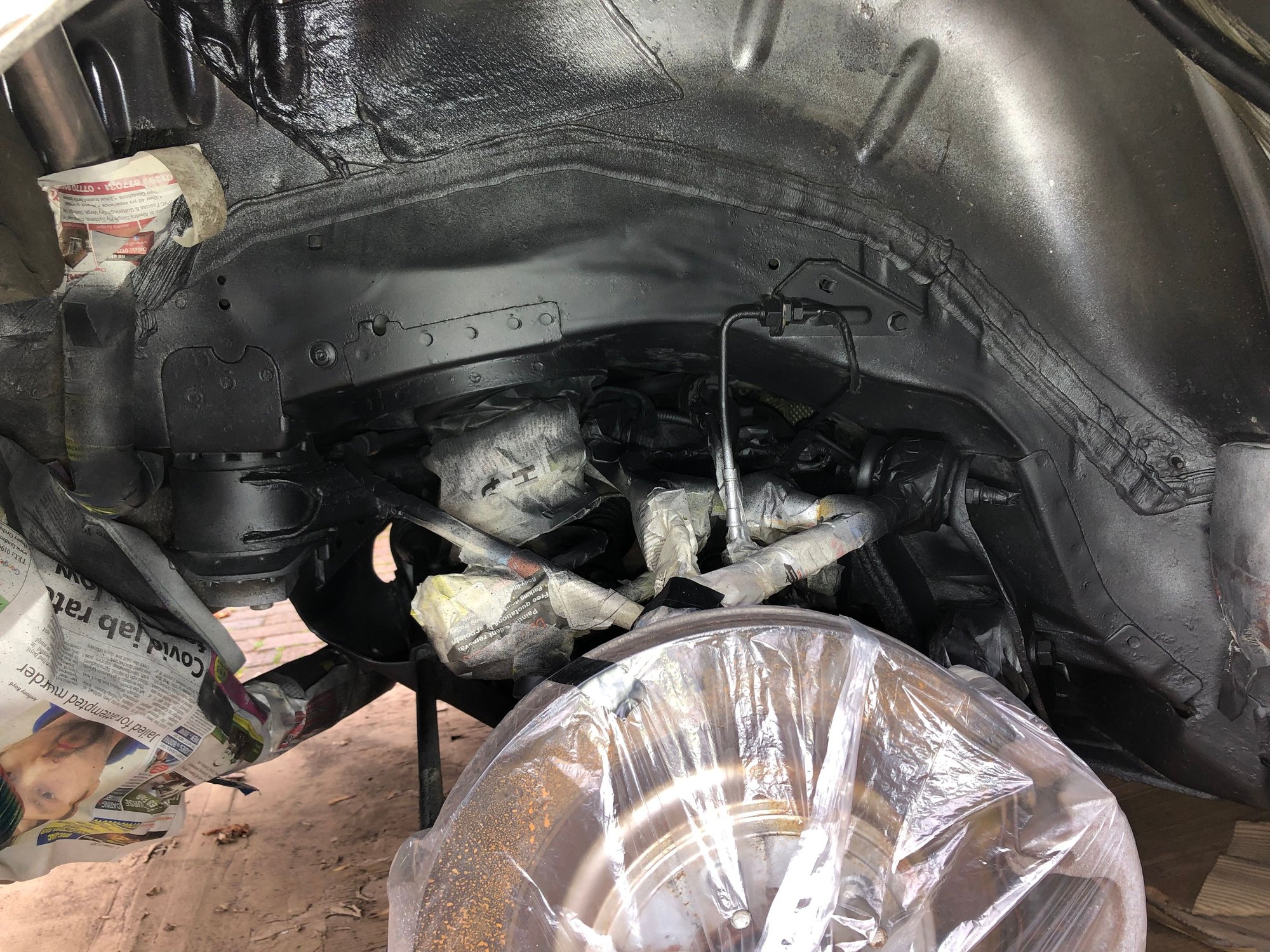

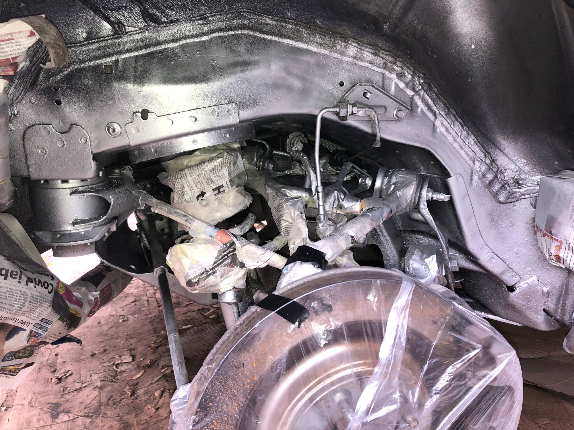

anyway, it has now been rust cured, zinc primed, stone chip paint, under-sealed (non setting) and then also give a coat of underbody wax and I treated the doors, sills and other various cavities. Luckily I have all the gear for my classic cars.
this car won’t be rusting any more.
here are some more pics.

I like to keep the engine bay clean and shiny as well so I only used cavity wax around the engine bay and there are some rails going front to back quite low down so I coated the outside of those with cavity wax.
I once had a triumph dolomite sprint that was ziebarted round the engine bay. When I drove the car hard on hot days the coating would start to smoke.
it didn’t stop the front panel and rear wheel arches rusting away though.
