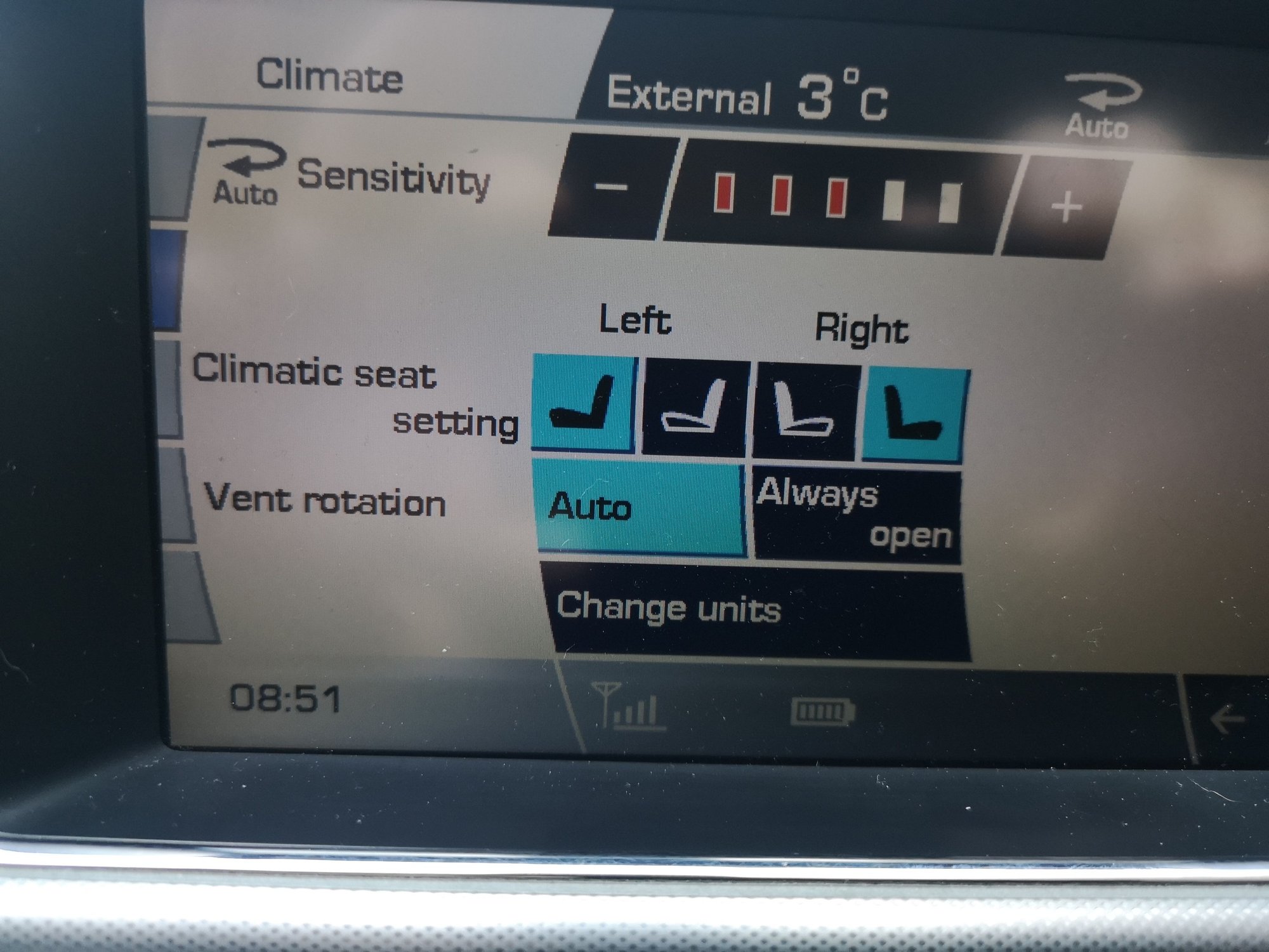

Originally Posted by John Williams
check the settings for the seats, as the bottom & back can be switched seperatly so might be switched off!
I wasn't aware of this, will check it first. Thanks.
One other thing check the settings for the seats, as the bottom & back can be switched seperatly so might be switched off!
I don't think that's correct. Each seat is either on one of three cooling settings or off. There isn't independent control of seat base vs back cooling
Nup it is correct, there is a setting in the screen menu to select whole seat or just base. Mine was already on the whole seat though.
On the vent issue, try pulling the codes via the OBD port. I think damper issues can get logged as a code.
Old 01-13-2021, 06:06 PM
BritCars's Avatar
Join Date: May 2012
Location: Boston, MA USA
Posts: 2,407
Received 438 Likes on 387 Posts
Strange. I've never seen that screen before. But looks like it does as you say. I just use the controls on the main screen.
