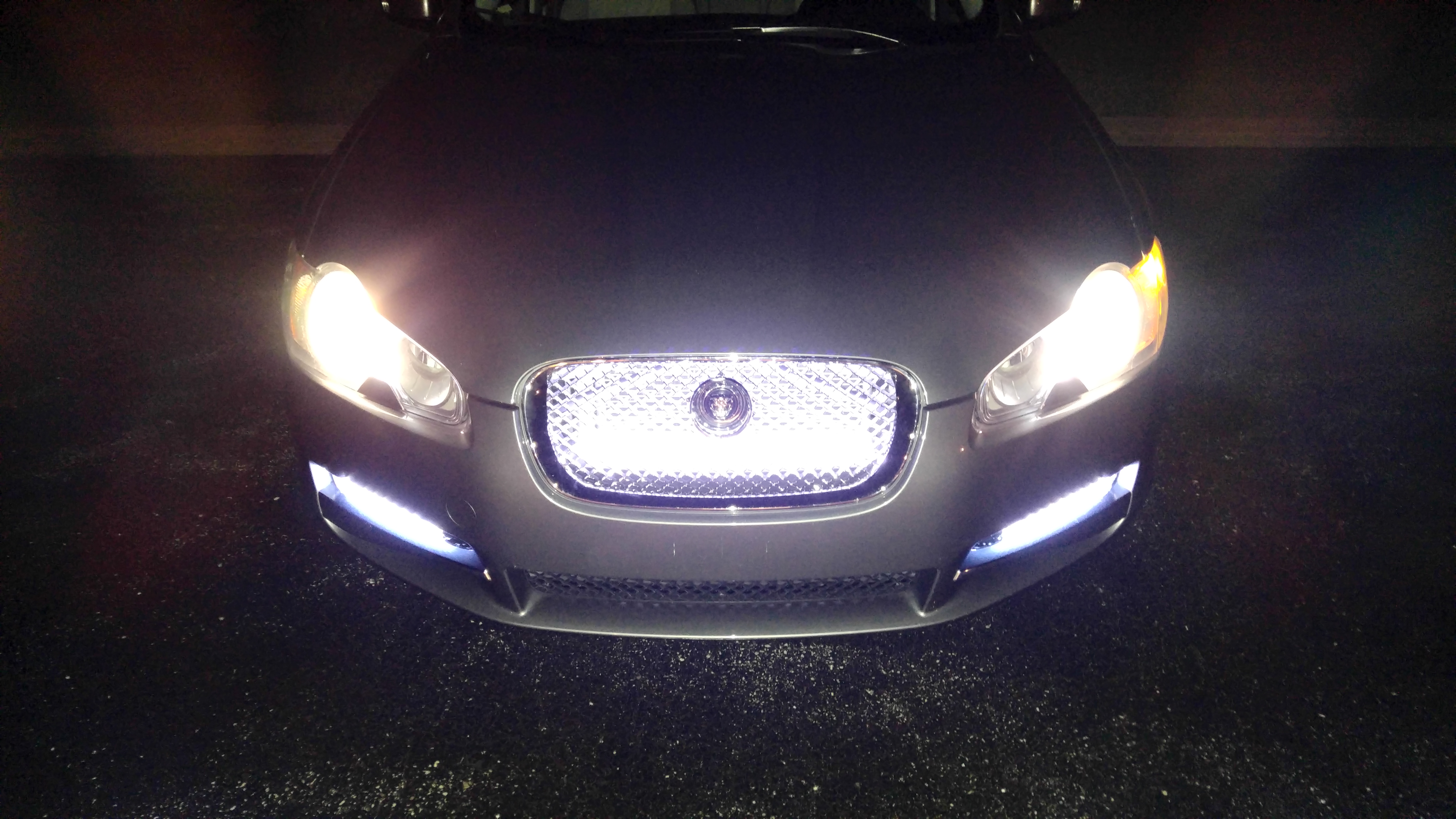

After reading numerous posts about how the 09 XF does NOT come with DRLs, and seeing a few interesting mods in the forums, I decided to give it a try.
First I have to say it is extremely easy to remove the front bumper and grille on the XF. A few bolts on the bottom; a few on the top; and then the whole unit pops out with a little tug on each side to unhook from each quarter panel. Crazy easy!
From here, I added a couple of LED strips just above the silver bezels on the bottom left and right, and then added a strip inside the radiator air intake cavity to illuminate the grille from behind. (see pic)
Lastly, I added an HID conversion kit to match the color of the headlights to the LEDs (not shown in pic).
All of this could have been completed in one weekend, if I had had all of the parts on hand. I was too excited to get started, so I added each mod over 3 weekends as the parts were delivered.
I'll add more pics if anyone is interested in the details.

Sorry for the delayed reply. I've been out of town on business. Attached is a closeup of the DRL. In short, I cut a notch out of the plastic grille so that the DRL would slide in from the front. I then attached with two screws.
Also attached is a pic of the fuse box in the engine compartment. I had a really hard time finding a 12V switched fuse position that didn't cause any problems when tapped. I settled on this black fuse which is associated to the ignition system. If you use this position, be careful to A) make sure you have a solid contact between the fuse and the slot contacts, and B) reinsert the fuse with the top symbol facing the exact same way before you removed it. If after you tap this fuse the car turns over, but doesn't start, then one of the above must be corrected. Found out the hard way.
Just to be pedantic...that's not a fuse. The electronic symbol ->|- indicates a diode. Only flows current in one direction (funny seeing it in a fuse box, but, then, what the heck), so if you don't put it back the way you removed it, it will prevent the flow of electricity...as you found out. the arrow points in the direction of current flow, by the by.
As to why there's a diode located there...well, I'd have to look at a diagram. But, it's not a fuse.
