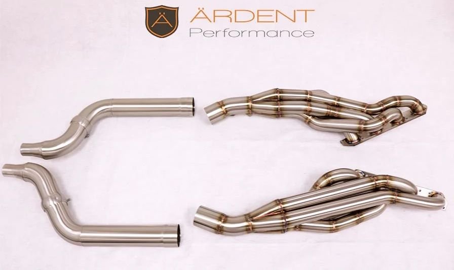

Hey I love the idea of headers for these 5.0L cars!
But don't re-invent the wheel!
Here is a beautifully fabricated set and it should fit you XF as they were made to fit the XFR-S.
In case you have not heard of Ardent before they are a well known UK supplier of (EXPENSIVE) Jaguar upgrades. All of it top notch quality too.
Just look at those welds. Nice just nice!
And it all fits into the stock setup.
And of course now comes the fun part! Price!
They are about $3K a set without cats.
Check out the other parts while your there.
Ardent Jaguar Parts

I have these headers on my XFR-S. The do make the car louder and change the note a little. Mine are the catted version, but you'll still need a tune to deal with the P0420 that you'll get from going to the high flo cats.

These exhausts are not UK based. They are made in Arizona. I've been in their shop. They installed these headers on my XFR-S.

yeah, I have NO DOUBT they are awesome! I just can’t swing $4K for the headers alone right now. (It’ll be for my DD, and I live in an inspection state so I have to get the catted version).
I was just hoping to find a slightly more budget friendly header. Plus, as my application is an LR4, I’m not 100% they’ll fit…I mean, they should…I’d just be really upset if I got them here and then ran into an interference issue.

Hey thanks for that extra background but can we purchase them in the US? Is Ardent only in the UK. They have been supplying Jaguar performance stuff for a few years at least.
Do you think there was much power gain?

I believe Ardent is out of the US, Phoenix Arizona.
as for the performance gains, I don’t imagine it’s much…maybe 5-10HP at the wheels, but what you will see by opening up the exhaust is a HUGE reduction in back pressure and heat soak associated with overdriving the supercharger. That in and of itself makes it worth the cost.
