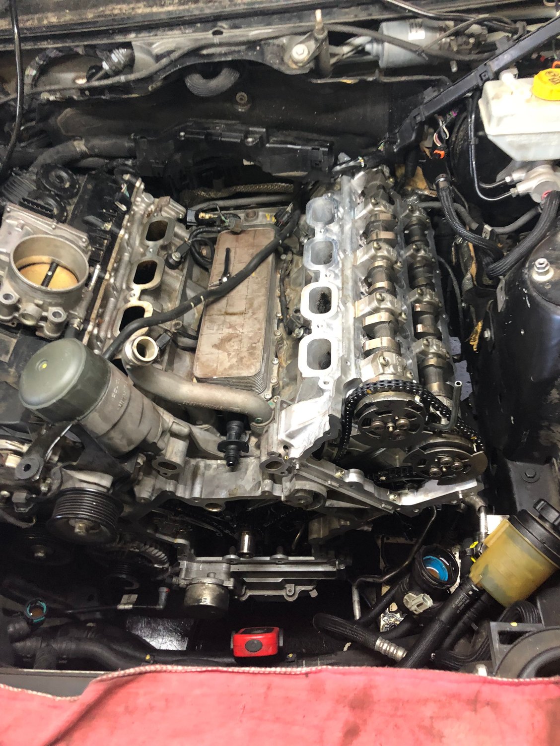

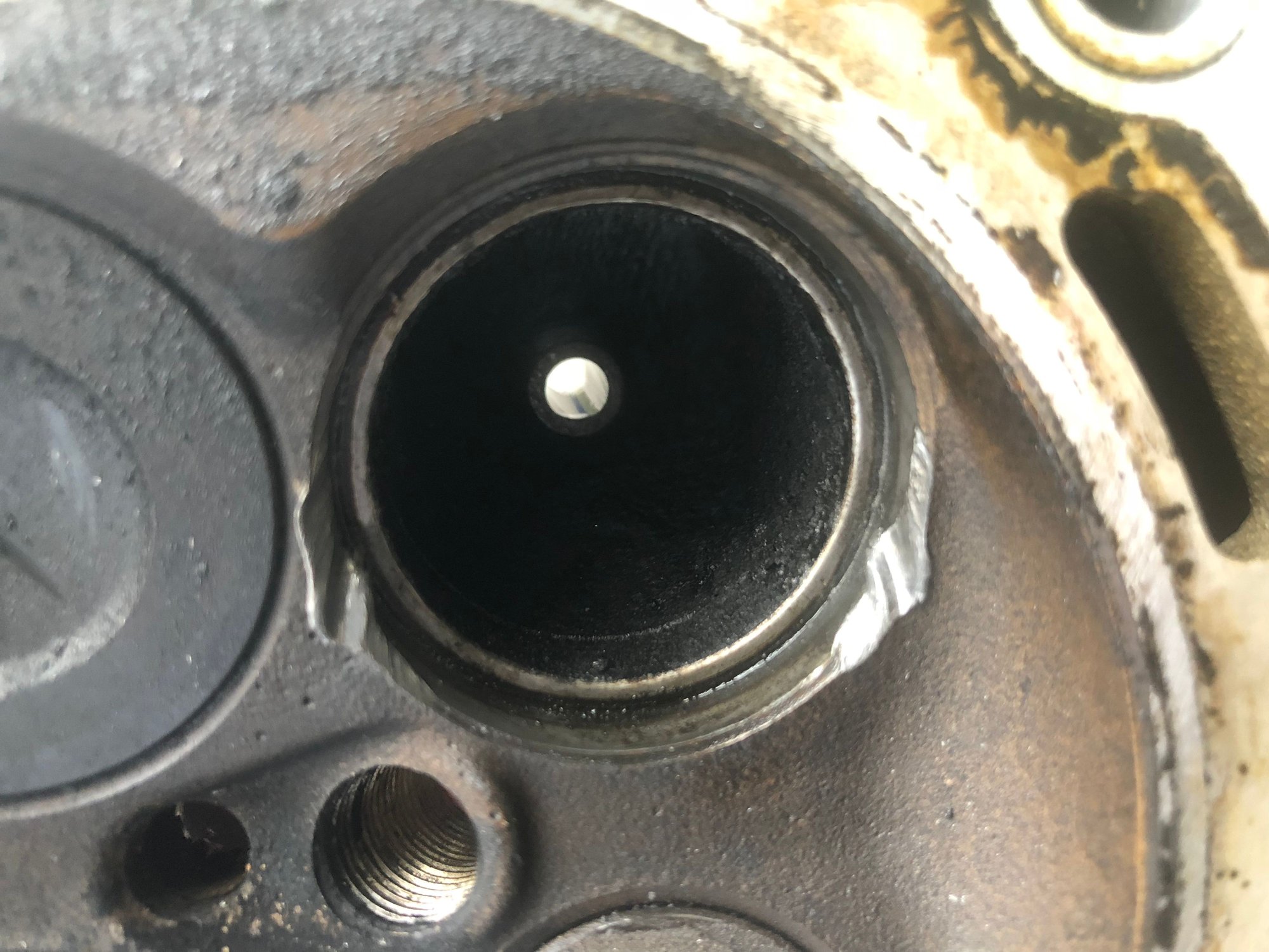

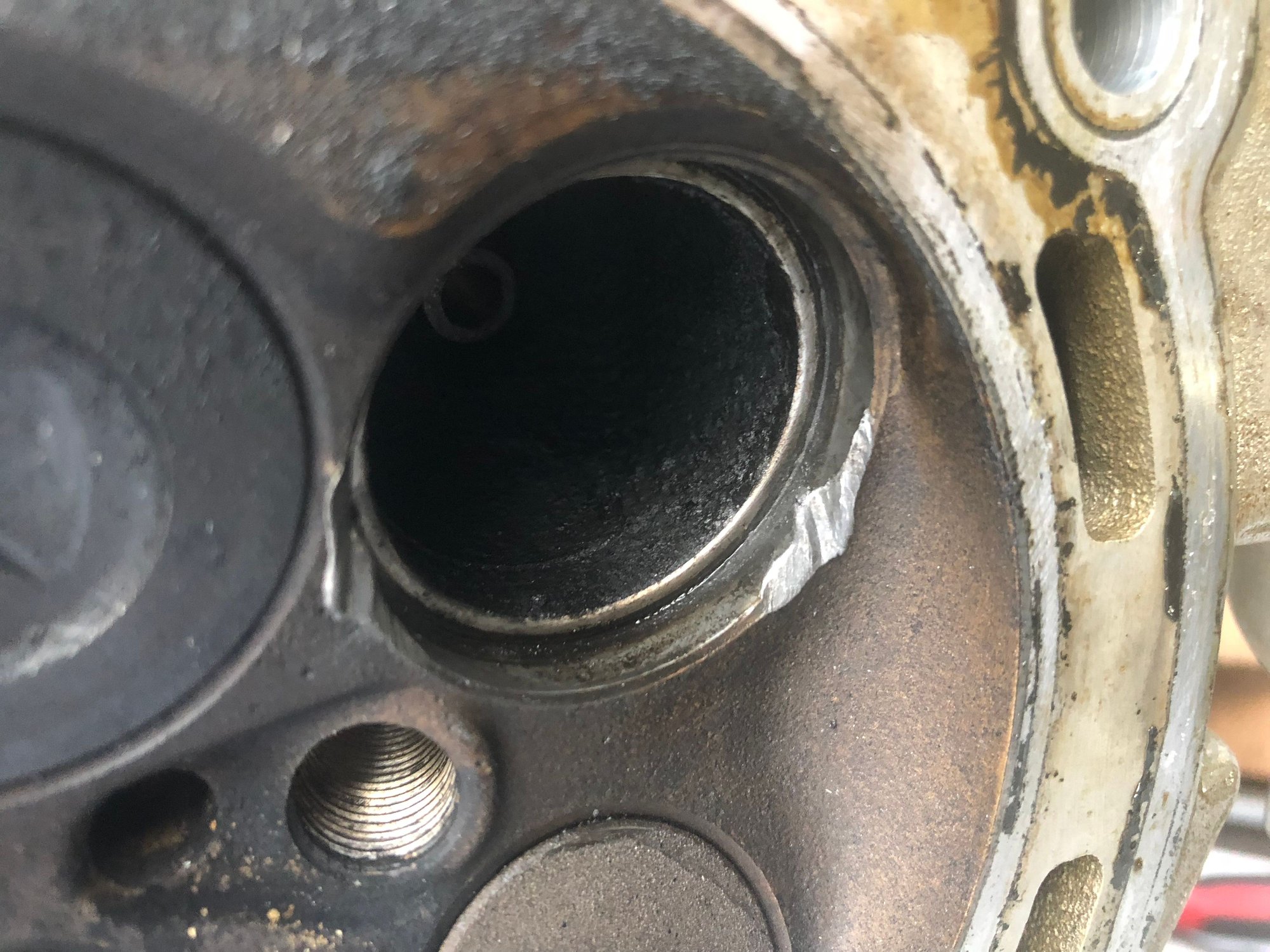

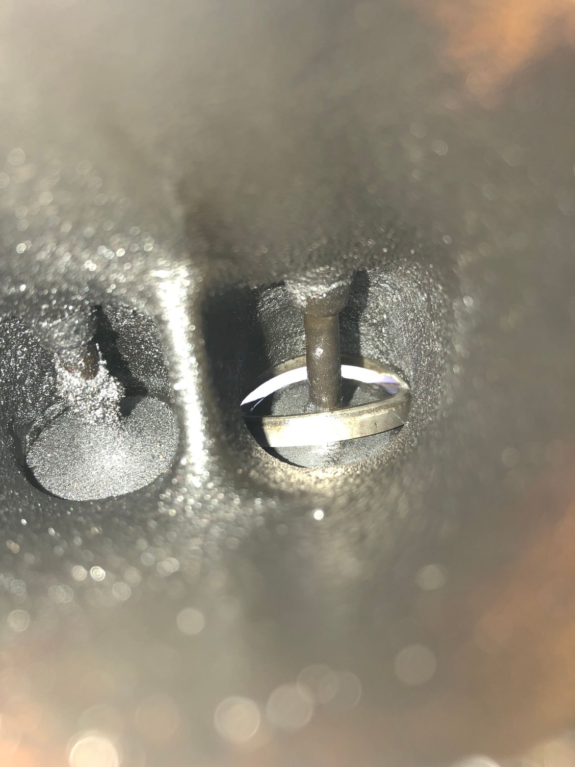

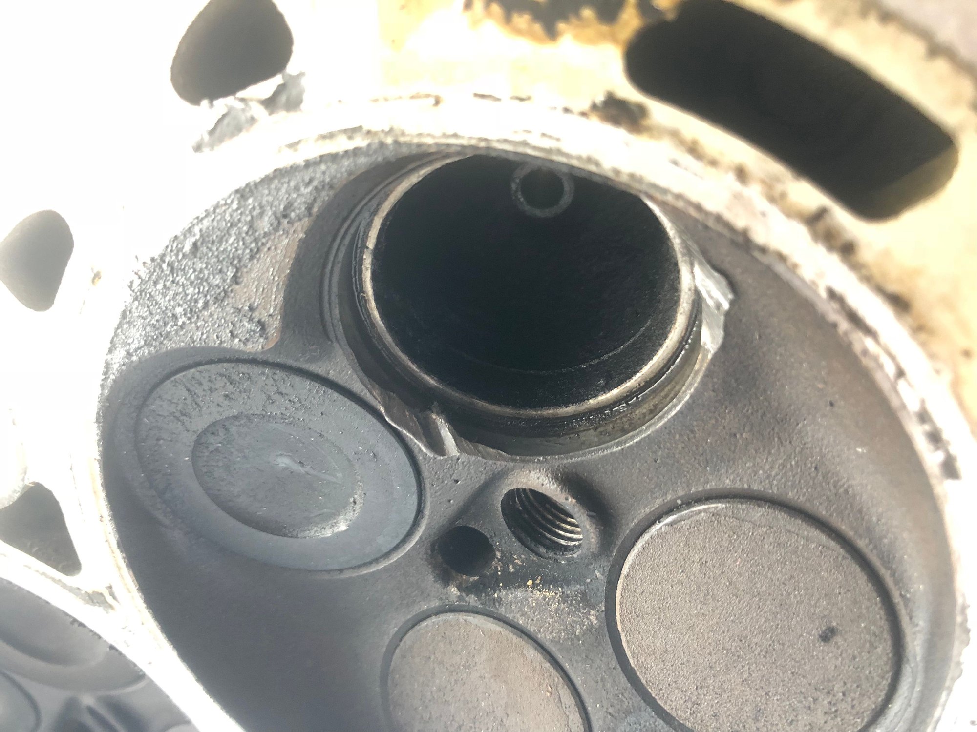

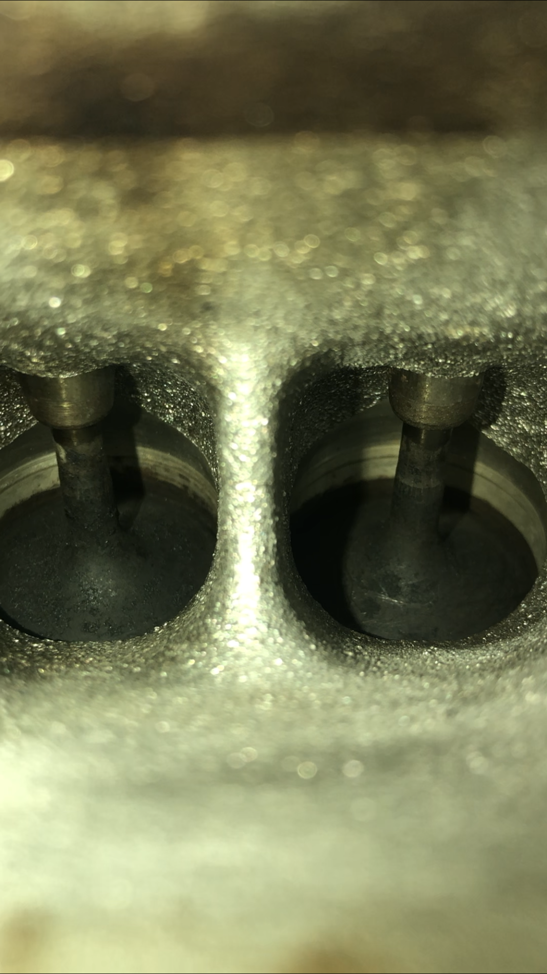

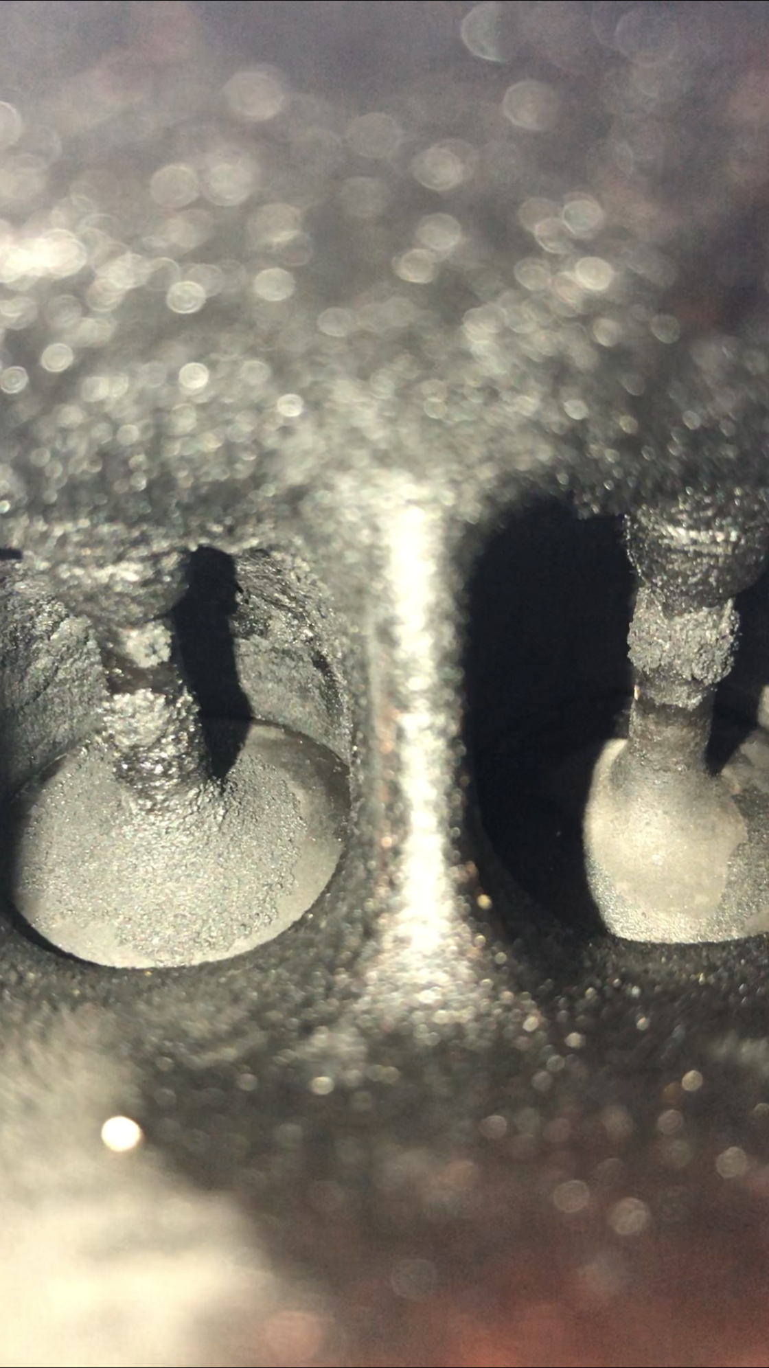

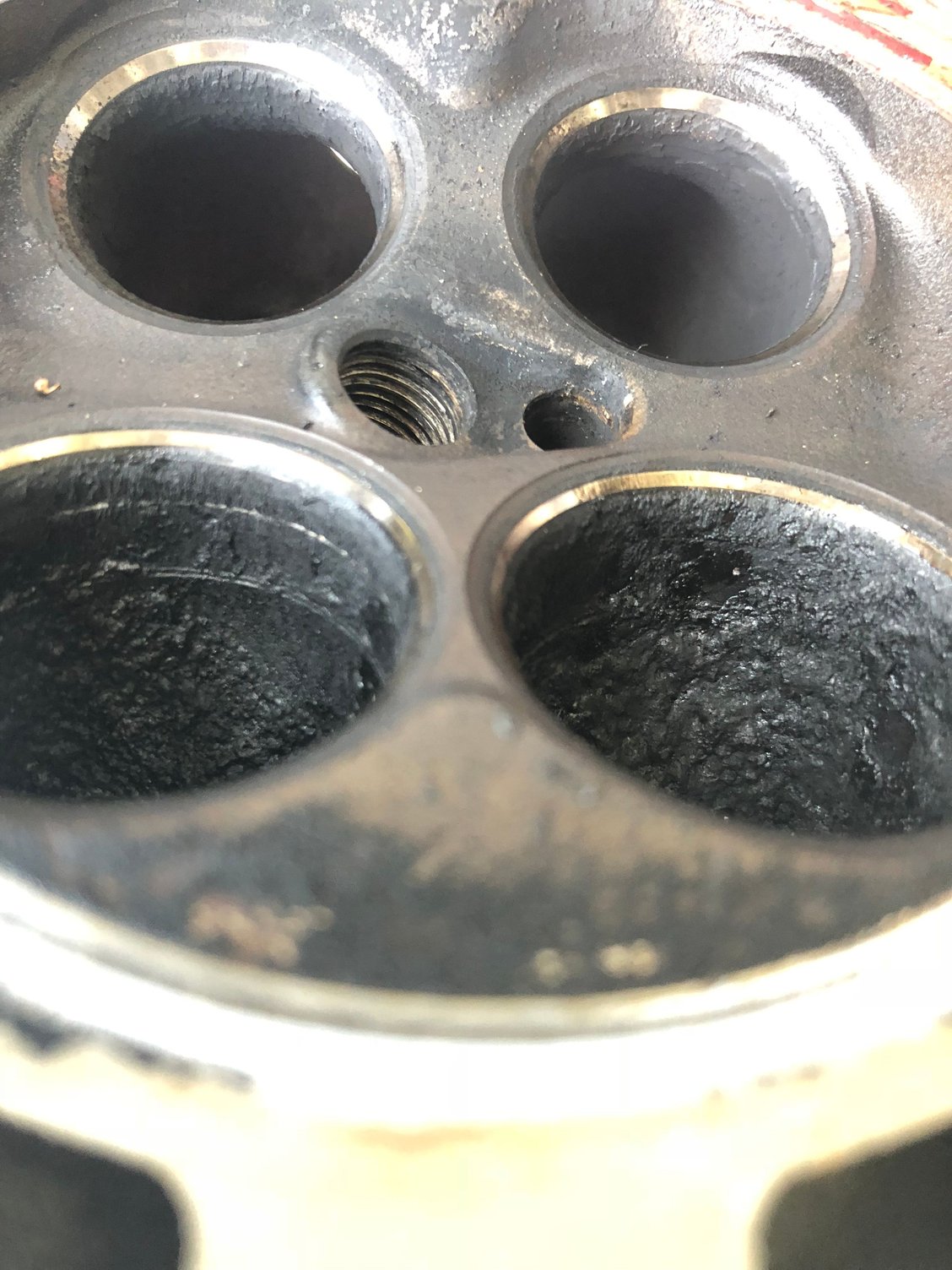

100k, 3rd Water Pump, and BOOM.
Should have replaced the Water Crossover Pipe...
Here are pictures to show Progress!

Over 500 miles on her after repair!!!
Very fun engine to work on!
Let me know if you have any Questions!
No special tools used for dissasembly or assembly!

Man that valve seat come right out like that.
Old Jul 27, 2018 | 10:52 AM
Kenika65's Avatar
Joined: Jul 2018
Posts: 25
Likes: 9
From: Austin, Texas
Whats Crazy is it never touched the Piston...
With the Spark Plug removed you could see the Seat moving with engine rotation, made for an easy Diag!
